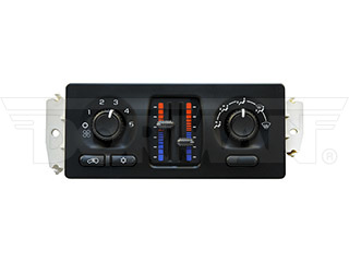

Does anyone know of a source other than Dorman to get HVAC controls from? Mine has been dying for a number of years, but it is getting worse now. A few years back my AC wasn't working. A friend of mine and I traced it back to the actual AC button/switch on the board in the HVAC control. Non-repairable, and at that point I should have swung for a new control unit. Instead, we took a closer look at the wiring diagram and bypassed the button on the dash. The relay for the AC/ AC compressor works on a negative/ground trigger to engage the compressor. So, we installed a switch under the dash and triggered the relay manually to engage the compressor clutch. It has worked great like this for years, but I know it has been harder on the AC clutch running it this way, and it is finally taking its' toll. The clutch will engage and work for a few minutes driving around town, potentially longer driving constant 2000RPM on the freeway, but it eventually stops working again. Just this week I was getting hot air out of the driver side vents while getting cold air out of the passenger vents with both sliders all the way down. This tells me something else is going out in the HVAC control module now, and if I replace the compressor clutch, I should make it function correctly this time.
Anyway, it looks like only Dorman is remanufacturing these things from what I can find online. Is there possibly another source? I haven't had the best of luck with Dorman electronics over the years. If not, I guess I can give it a try, but expectations will be low.
For reference I have the most basic control unit that looks like this
Dorman # 599-003

Try ebay for even OE new units. Be aware, you may have a blend door actuator problem, too.
I've been searching Ebay for years now! I know that sounds like a stretch, but from time to time I will find all the OE part numbers and just throw them in an Ebay search, but I haven't found anything good yet. Just a bunch of new no-name generic garbage. Good suggestion on the blend door actuators, I'll make sure those aren't faulty too. They are all noisy, I can hear them when I move a knob or adjust the slider. I am really thinking the issue lies in the control, but I could be completely wrong. Seems like something is internally shorted specifically on the AC circuit somewhere. I don't have issues adjusting the fan or temperature when it is cold out and I need heat.

Have you tried a junkyard replacement? I personally like that style and thought they were more reliable than the automatic version?
Module Master shows they rebuild your style of AC module for $45. Worth a shot.
I agree, I have bought reman/rebuilt HVAC auto heads and had good luck.

I have heard they are more reliable as well. But, my sierra is now 21 years old with 265K and a lot of hours. Prior to my dad owning it, it was a shop truck for a steel business in Northern Idaho. Can't really blame it for calling it quits after all these years...
Honestly, I have never heard of Module Master. I will have to look them up! Thanks for the recommendation!
