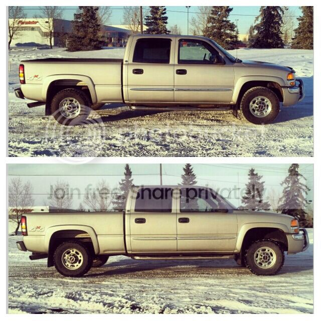

Wish I would have taken measurements to actually know how much the front came up, but here is a before and after.

That picture was just the front. But I'm not sure if the 1500hd sat higher stock or not. Those are also only 265/75/16 tires.

I'm guessing 2" in back will put it about an inch higher than the front. But that's just a guess. It's it 2" lift in the back or a 2" block. You may already have a1" block from the factory that you will replace. Therefore if your getting a 2" block it will only raise the back 1"
