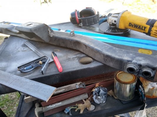

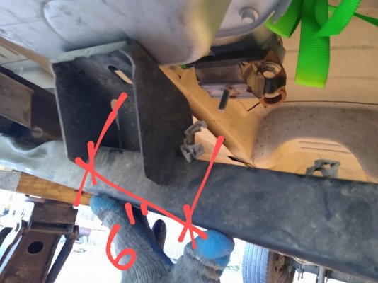

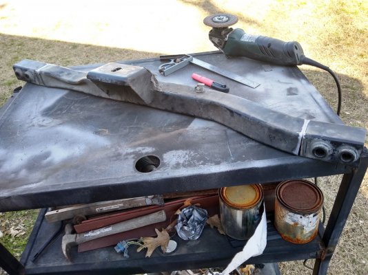

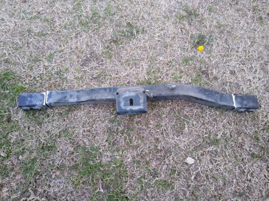

On my 99 ECSB 2wd I just cut the cross member and welded some plates to shift the mounts back 6". This is the earlier generation of cross member. A guy on a different forum later told me the little raised tower just had to be flipped on the cross member.

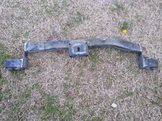

Post a photo of what you have.

Take some measurements of removing the little mount tower and flipping to the back side of the tube. If that gives you the 6" offset, that may be easier. I didn't know about that and I had already cut my crossmember as shown. I did this based on Lawrence Tolman's swap on the Ugly Truck. His truck has the different crossmember though.
