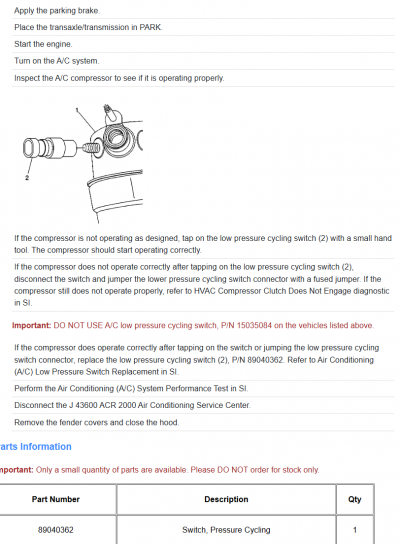

<blockquote data-quote="AuroraGirl" data-source="post: 26016" data-attributes="member: 9417"><p>You need a scan tool.it will literally tell you why ac is inhibited directly </p><p>Also, the tsb I posted was very specific about what switch is used. Did you verify the part number cross or original part number</p></blockquote><p></p>
[QUOTE="AuroraGirl, post: 26016, member: 9417"] You need a scan tool.it will literally tell you why ac is inhibited directly Also, the tsb I posted was very specific about what switch is used. Did you verify the part number cross or original part number [/QUOTE]
