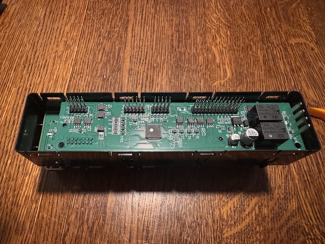

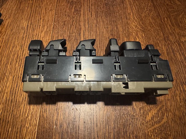

8 snap hooks around the perimeter hold the housing together.
After you remove the bottom cover, you will see the first PCB.

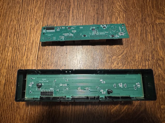

It is simply supported by pegs and has an easy dupont style interboard connection. It just lifts out.

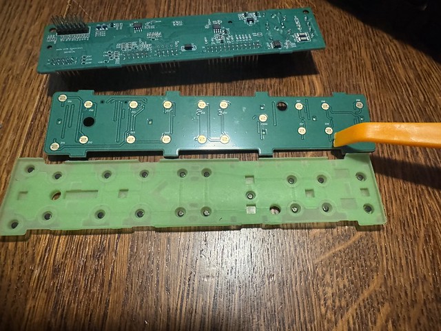

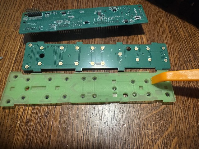

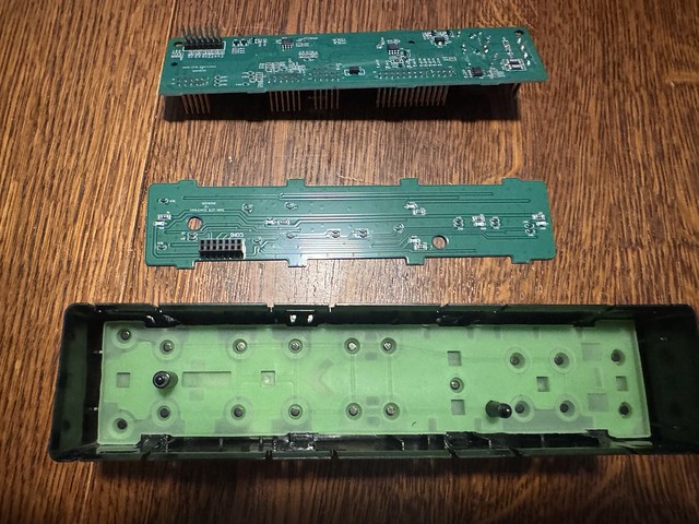

The inner PCB is the "difficult" one to remove. It has 8 clips around the perimeter. Just keep at it and it'll come out. It may or may not come out with the membrane contacts. Mine did not. The membrane simply lifts out.
You need to clean the PCB contacts (gold) and the membrane contacts (black). I used IPA.
To reassemble, just go in reverse. I lay the membrane in, then drop in the inner PCB. I go all the way around the PCB and make sure all 8 snaps are locked in. Then I drop the smaller PCB on top, making sure the pegs are lined up so the interboard connector goes in correctly.
