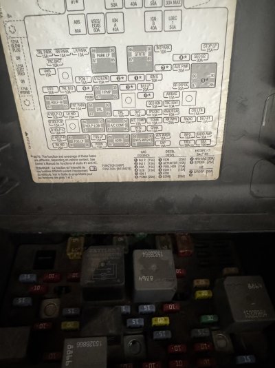

does the black wire go on the middle blade or bottom blade after I've installed the top red wire? Also My BU/ LP and AUX. currently both have 20amp fuses so in the wire that has the 2 horizontal clots what amp fuses do I use before I plug it into the B/U LP and on the wire with the fuse holder going to the relay what amp fuse should I put inside of the holder? Thanks

358
888
The black wire on my setup is just a ground. I slid it under the fender bolt. You can see it in picture with the blue fork terminal.
