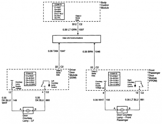

<blockquote data-quote="Tonimus" data-source="post: 24615" data-attributes="member: 12914"><p>[ATTACH=full]3760[/ATTACH]</p><p></p><p>This would suggest that if everything else works as it should, there's something wrong with the DDM that's not triggering the light when the door opens. Check all your connections at the DDM for corrosion and good connection.</p></blockquote><p></p>
[QUOTE="Tonimus, post: 24615, member: 12914"] [ATTACH type="full"]3760[/ATTACH] This would suggest that if everything else works as it should, there's something wrong with the DDM that's not triggering the light when the door opens. Check all your connections at the DDM for corrosion and good connection. [/QUOTE]
