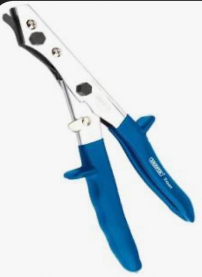

On extended cab doors, you have to watch the mounting depth or the magnet will hit the back of the door skin. This is for when you install replacements in the factory location. Hole opening is a 4x6. What I’ve ran across before is even though you get a replacement 4x6 speaker does not mean it’s a direct fit. I ran across this on my 02. I was installing Sony Xplod 4x6. The magnet and speaker cage was slightly bigger than OEM; I had to cut some metal for those to fit.

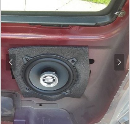

My current 04 has Powerbass L2 series 5 1/4, 2 ohm speakers in place of the 4 inch Bose speakers. I went with these since there was very little metal to cut for these to fit.
These also fit under the door panel grill with no modifications.
Most aftermarket speakers include a template. I use a Sharpie to mark the cut lines and the holes for the mounting screws.

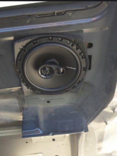

I’ve also installed 6 1/2 speakers in a couple of non - Bose trucks. This is a Rockford Fosgate R165X3 (6.5) in an 03 extended cab.
