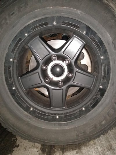

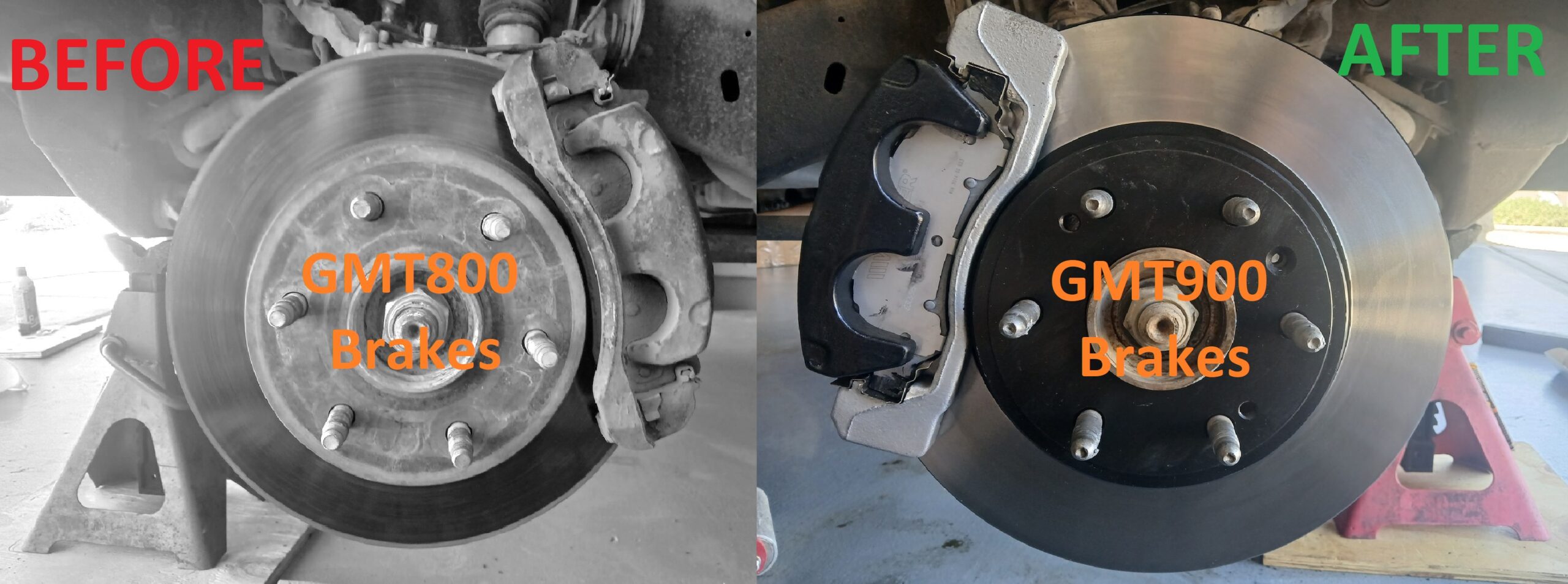

I cannot confirm factory 17s, but here is my 04 with GMT900 brakes and aftermarket 17s. Of note, this brake "upgrade" was available on some GMT800s from the factory.

GMT900 front brake update-upgrade for GMT800 is FAR simpler: 2010 caliper brackets, calipers, rotors, & pads, + 17" GMT800 or GMT900 wheels, reuse brake lines =
DONE.

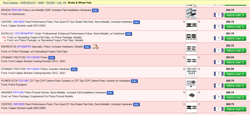

Glad you got it figured out! Just an FYI, there are two different calipers that use different pads. This is information for the next time you do brakes on the truck. 1092 pads pair with 285/286 calipers. and 1363 pads with 351/352 calipers. Again, just an FYI if you need replacement pads. You can see what I am talking about in this screenshot. Look at the centric part #s 306-1363-0 and 306-1092-0.
As far as the rear brakes, who knows what GM was thinking. I assume lowest bidder. Single piston rear on regular cabs, dual pistons on suburbans. They eventually went to drums on the rear of the GMT900s. I guess that's what we call "progress".
