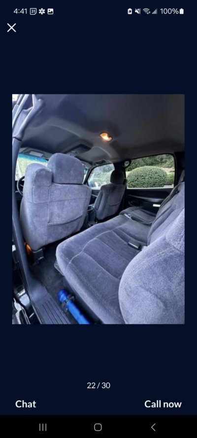

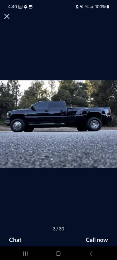

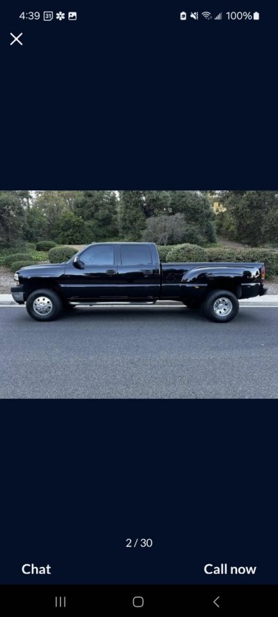

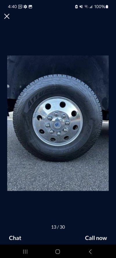

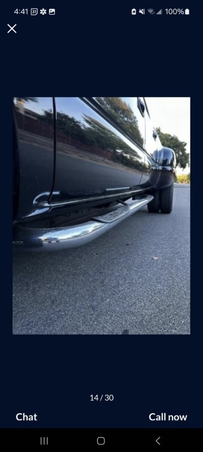

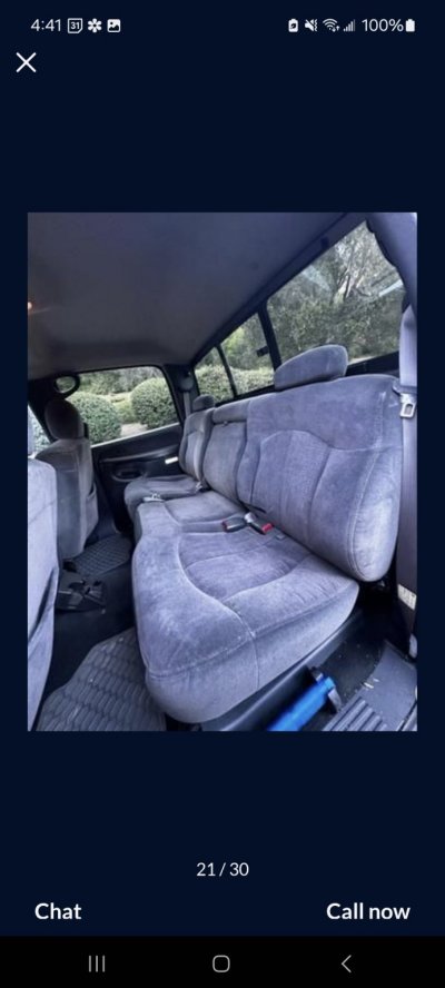

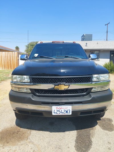

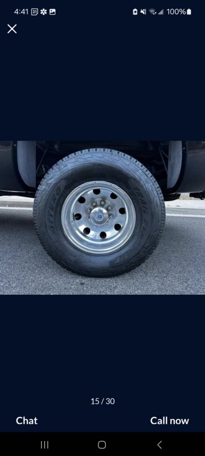

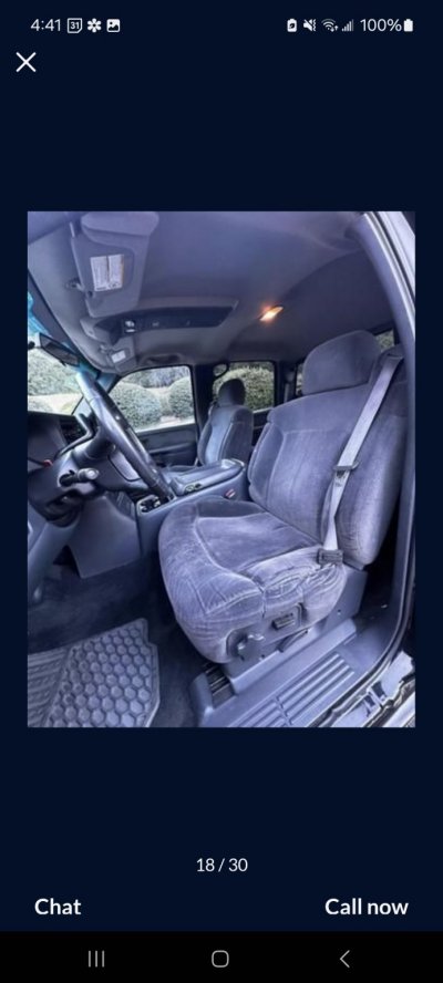

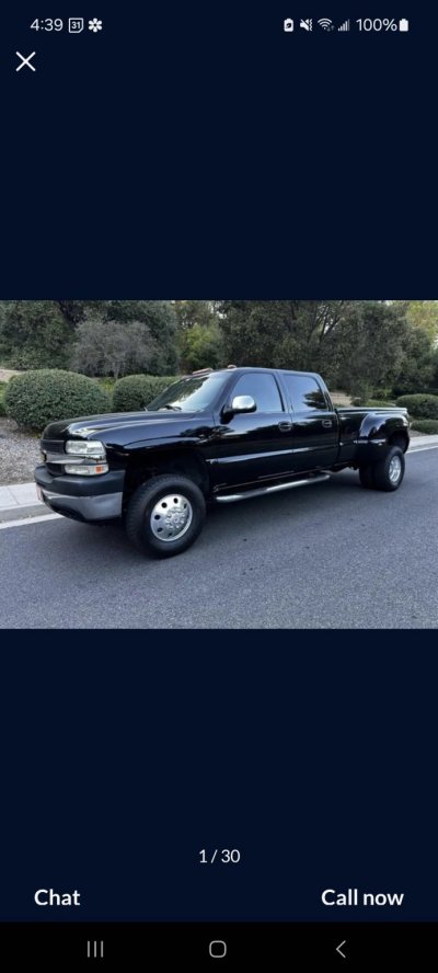

Hello everyone. I bought a black 2001 Chevy Silverado 3500 crew cab lq4 in October 2024 and would just like to introduce my buy. I bought it at an auction that started off at $2000. Fortunately, I got it for $3200. When I drove it home, I realized that the engine had a slight rod knock, some bulbs were burnt out, needed major front suspension work, but it only had 57,500 miles. Apparently, the car was a previous crime scene (never really got the full details on that) and had damage on the front driver side fender that was replaced by a previous dealer that couldn't sell it, so they sent it to the auctions. Other than that dang rod knock, everything runs fine. I've replaced many parts since.

57,000 miles? Great buy, even if you need to replace the engine.
Curious (and ignorant & too lazy to look it up) - which engine does it have?
he said LQ4 (6.0) in the op.
which surprised me but I guess chevy did do the 6.0 in a dually.
welcome to the OP! what a steal. clean title issued?
