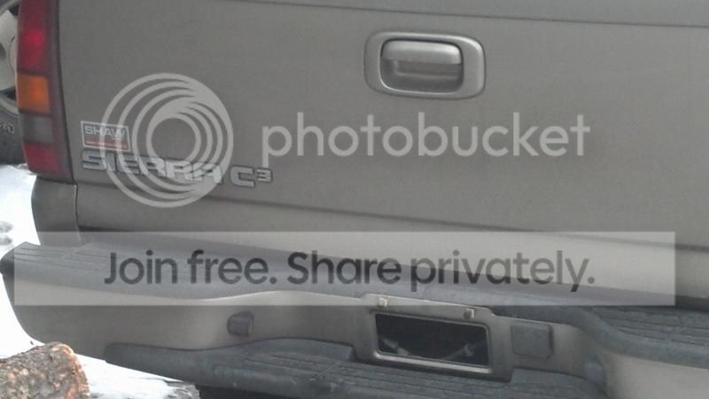

awesome story man, you should post pictures of your truck
