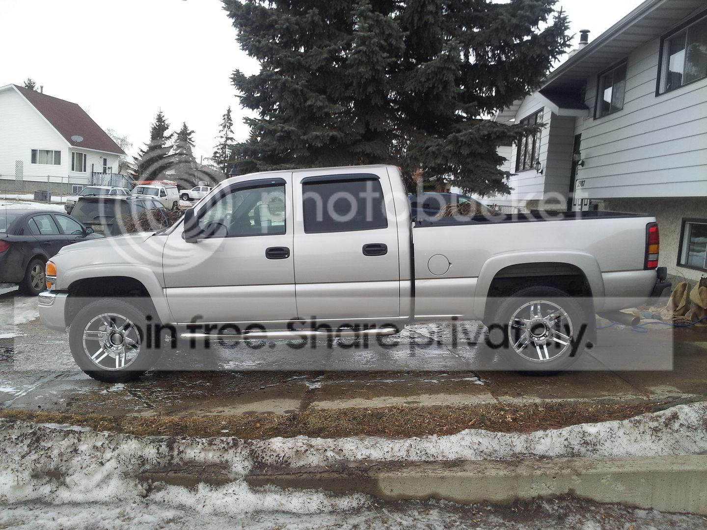

Mine:
2006 1500hd
305/55/20 measures about 33x12
Wheel 20x10
About 5" backspacing, think offset -9 (will update if I find out for sure)
1" lift block rear, cranked level in front
Fenders measure 40"
Trimmed lower bumper and inner wheel housing plastic. Also hammered back some metal behind the plastic. Lower corner by the door.

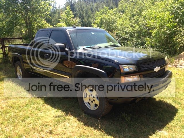

02Beast
383
Duncanville, Alabama
02 Z71 Tahoe
6" RCX NTD lift
35x12.50r20 toyo open country m/t
20x10 method standard wheels
-24 offset
Almost maxxed on t-bars
Slight trimming

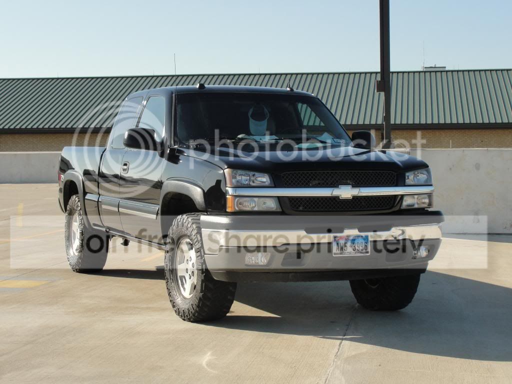

[/URL][/IMG]
[/URL][/IMG]

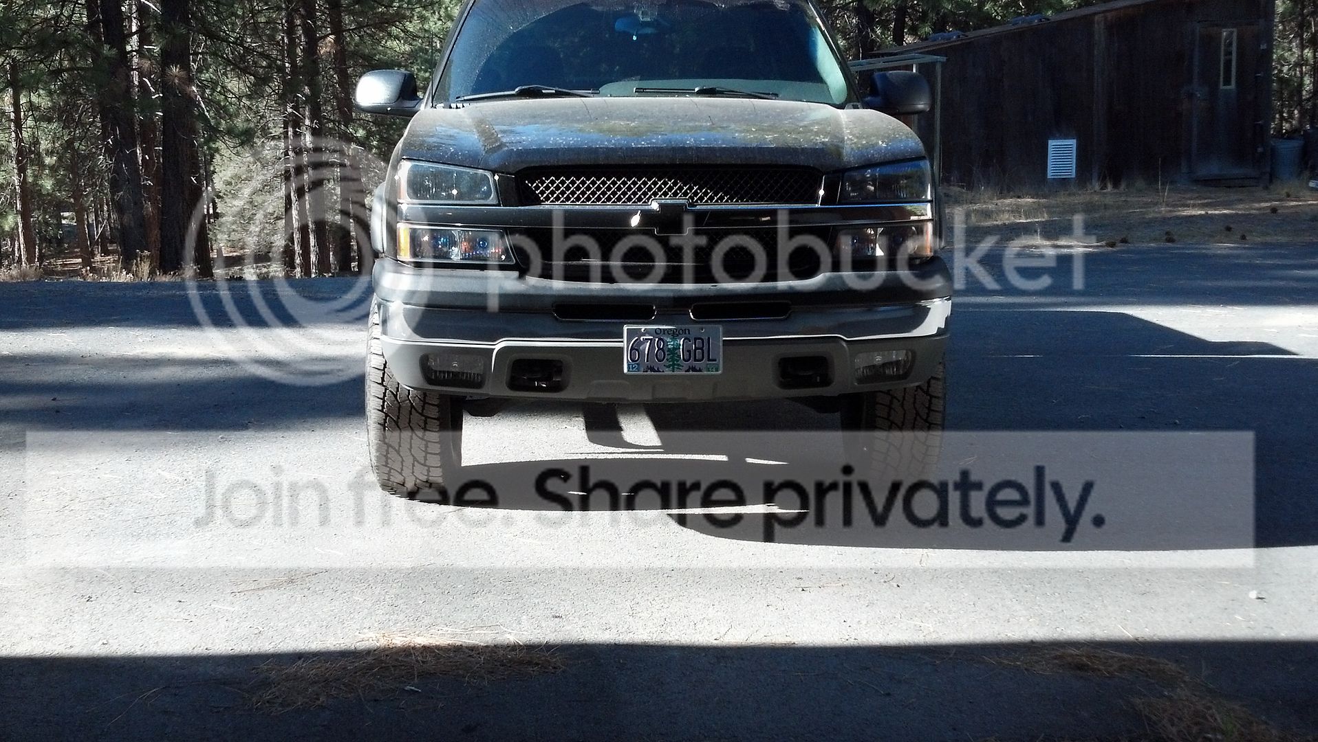

2003 1500HD
Tire: 285/75r16 33x12 (came with the truck when i bought it a year and a 1/2 a go)
Wheel: 16 x 8 (-6 offset)
2" Keys
Billstein Shocks for leveled trucks (need to be installed)
All I had to do was trip a 1 inch square section in the corner of the lower bumper valance. It is hardly noticeable.
Here is a picture of a me next to a stock 1500HD with stock tires
When its time for new tires (few years from now) I will upgrade to 305/70r16 ro I may upgrade to some 18" wheels but we will see

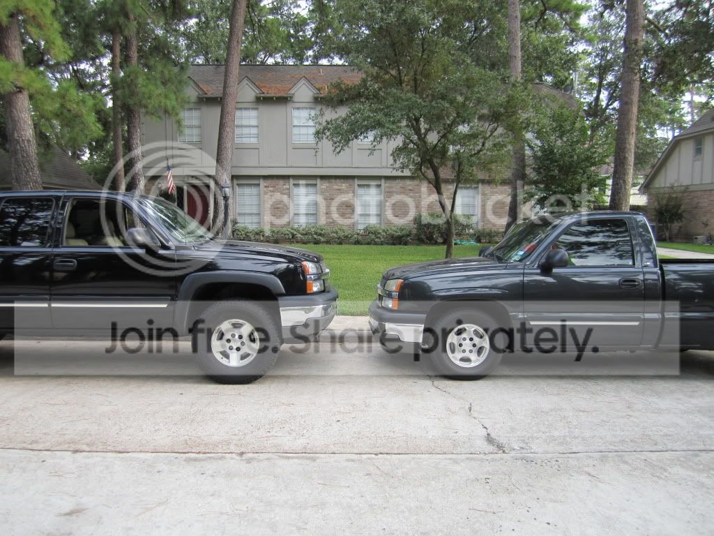

2005 Silverado Z71 leveled only, no trimming.
315/70/17
Same setup next to 2wd with lowering shackles in the rear.
35x12.5x17
285/70/17
