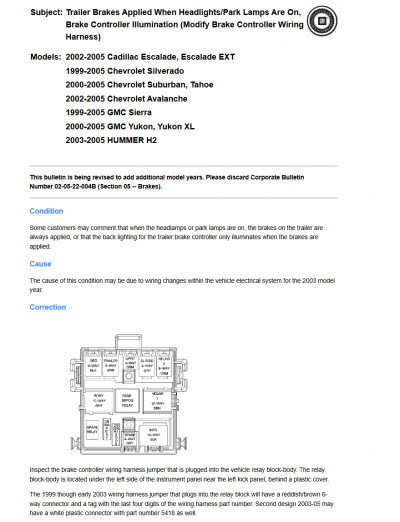

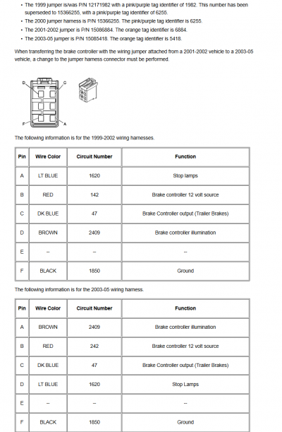

<blockquote data-quote="Classic-Al" data-source="post: 25096" data-attributes="member: 13096"><p>It worked! Finished the re-install, tested it in the garage, then hooked it up to the trailer and it all seems to work just fine. No activation at the trailer brakes when any of the lights are on, including signals or 4-way flashers. So, it turns out it was the connector after all. Well, I learned a lot in the process. (Mostly, try not to "overthink" the issue!) Thanks, all, for your help. It steered me in the right direction. </p><p>CA</p></blockquote><p></p>
