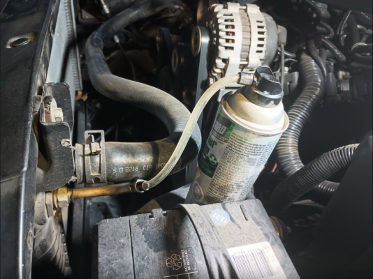

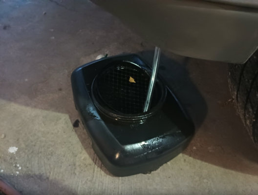

I was worried about contaminants that got inside the radiator, so cut off an old cooler line end and cut threads on one end to match the cooler clean can. I cut another old cooler line and just ran clear vinyl tubing to a catch can with hose clamps. Run the entire can of the cooler cleaner, then follow by blasting it with compressed air until everything is nice and dry. Not the same as those professional machines that pump the cleaning solution back and forth, but better than nothing and very inexpensive.
