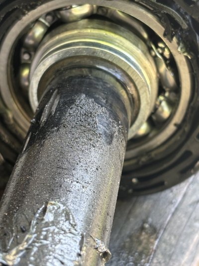

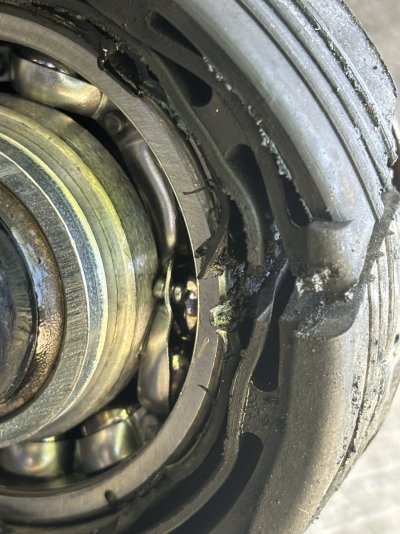

<blockquote data-quote="Daveb" data-source="post: 29718" data-attributes="member: 15016"><p>I put the truck up on jack stands and had my wife accelerate it to the start of the vibration, about 30-35 MPH. Was pretty obvious that the carrier bearing that I had a shop install was the problem. I did as careful of an autopsy on it as I could, and the attached picture is what I found. I will be paying them a visit on Monday.</p></blockquote><p></p>
[QUOTE="Daveb, post: 29718, member: 15016"] I put the truck up on jack stands and had my wife accelerate it to the start of the vibration, about 30-35 MPH. Was pretty obvious that the carrier bearing that I had a shop install was the problem. I did as careful of an autopsy on it as I could, and the attached picture is what I found. I will be paying them a visit on Monday. [/QUOTE]
