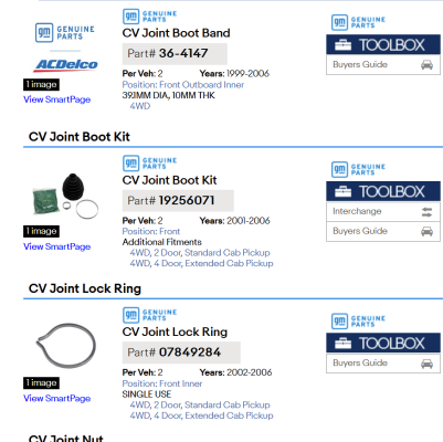

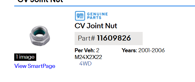

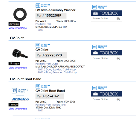

full CV axle is 26069244
251
601
Reminder: Plunge joints dont wear much, thats the inside joint by the axle. The outer CV is what wears. GM sells the CV joint as a stub with the boot , youd just have to regrease or at least seal the boot on the shaft and reassemble. I can get the directions to rebuild it if you want
