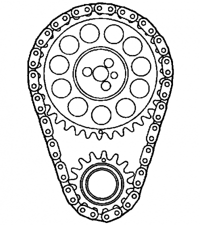

There is absolutely no way that the gear timing marks could be 180 off on one of them and the engine would start and run for a couple days. According to the pic I looked up for a 2000 4.3 "W" engine, this is how the marks should be at TDC. Is it a "W" engine? Look thru this info site and check that you have done the repair correctly: https://charm.li/
Notice in the pic, that not only is the dots pointed at each other but the locating pin on the cam gear is at 3 o'clock.

Yes, the dowel pin points at 3 o clock, I took off the chain sprocket and lined up the dots on the cam gear and the balance shaft gear, and then I had the number 1 cylinder up and both arrows pointed at each other on the timing chain sprockets, like your picture. They’re arrows on this truck instead of dots but exactly like that. I checked the cat last year when I did a clutch in the truck because I was worried that was it, but it wasn’t clogged then, fuel pressure is low but that is a new problem, we’re replacing the lines as soon as they come in, but the truck won’t fire with starting fluid either so I don’t think that’s is, could certainly be wrong though
