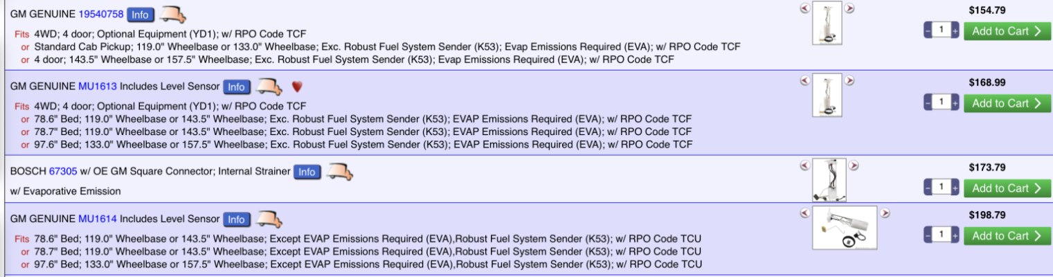

TLDR: Fuel pump may have kicked the bucket finally — still gotta check fuel pressure to confirm. Trying to find replacement and ACdelco does not have one listed?? That doesnt seem right. I checked rockauto and they have a couple options listed. Since this is a regular LM7 5.3 no e85 or anything it is an ext cab long bed (157.5” WB). Not sure which part number i should be using. I don’t have any of the RPO codes mentioned here:

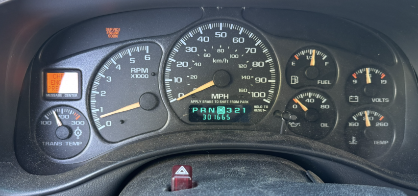

Well he made it to his destination, but called me when the oil pressure gauge dropped to near 0 at hot idle and got the check engine oil pressure warning on the DIC. It seemed to recover and but bounced up and down, did this a few times. No odd noises when raising engine about idle gauge goes up and seems to hold pressure. Oil just above halfway on hashed area of dipstick. At highway speeds (~2k RPM) it holds steady between 35-40psi. Anyways decided it’s probably the pickup tube oring and should be safe to drive back since it’s mostly downhill and an easy drive.

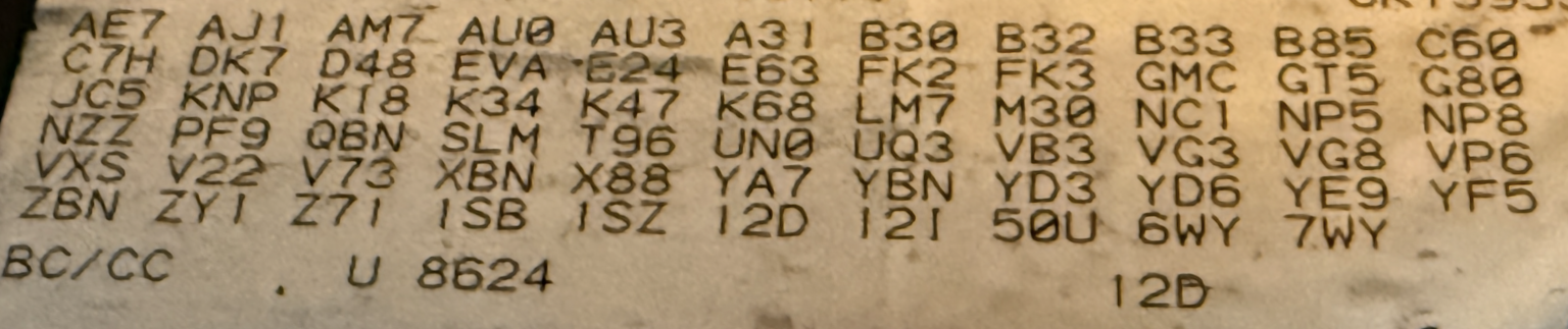

RPO sticker for reference:
310
796
That has the EVA RPO code. Evaporative emissions. Has the fuel tank pressure sensor attached to the sending unit. That would be the ACD MU1613. The TCU or TCF body code means the code on the pump housing, not the truck. I believe all the TCF sending units are for the EPA RPO code.
This is what happens when I keep working on this stuff late at night. I swear I looked over that RPO sticker 10 times and didn't see that. haha. I figured it would be since it was sold in California. Thanks for pointing me in the right direction.
