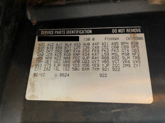

RPO Codes:

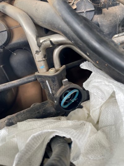

Day 2:

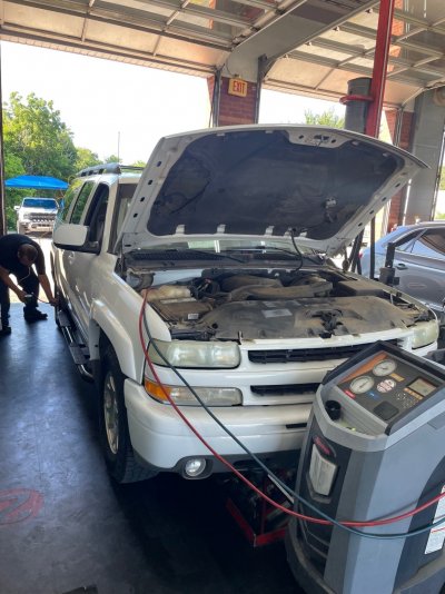

State Inspection (Emissions only) and Oil Change, engine / cabin air filters, and inspect why AC isn't working...
went with 10W-30 conventional
AC Freon measured within spec.
come to find out, the accessory tensioner pulley and belt were inop... replaced those, got AC just in time for TX summer

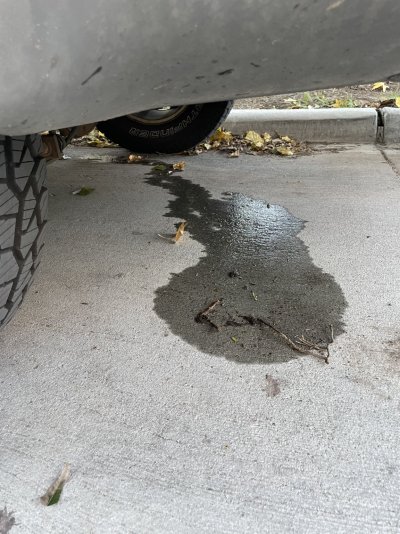

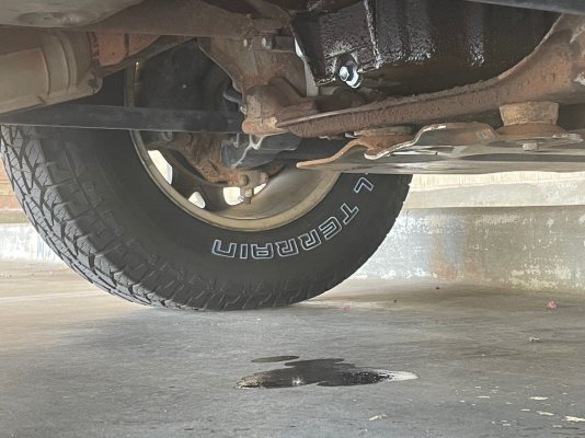

oil leak discovered, shop replaced the drain plug for me but the leak is a lot more than I'd like

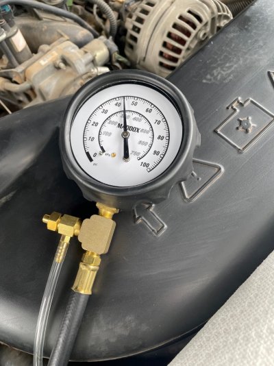

after a few weeks of long cold cranks, i started to look into fuel delivery related issues... seemed to drive fine once started and no CEL. would turn over easily when warm
Measured fuel pressure at the rail and it was below spec fuel pump priming key on, engine off. (30-35PSI and dropped)
June 28
my mechanic replaced the fuel filter for me
July 6

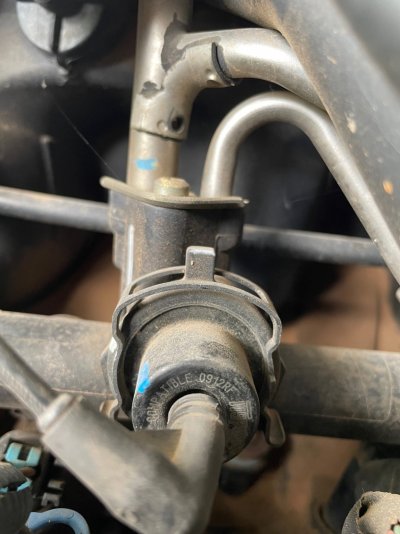

taking a stab at this myself before getting to fuel pump, my mechanic advised I check the fuel pressure regulator.
I replaced the factory fuel pressure regulator with AC Delco P/N: 217-1582
don't have a pic of the replacement part but install was fairly easy. I wish I had bought a replacement clip as it was a little difficult to get back on securely
fuel pressure at idle
the long cold cranks got a little better but still not where I'd like it..
I measured fuel pressure again afterwards and it had not improved, in fact it was a few PSI lower at idle, so I felt like the pump was on its way out. drivability wasn't getting any better either.
July 24
my mechanic replaced the fuel pump for me, AC Delco P/N: MU2295
no more long cranks, quick turning over, drove like a new vehicle again!
Two things: New light assemblies would be on my list.
The least the tech could have done was put a fender cover down so the a/c machine hoses did not rub the paint. C'mon man!!!!!!!

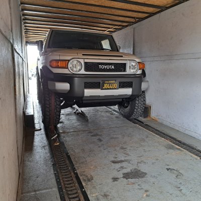

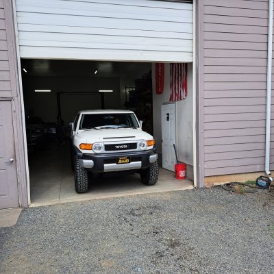

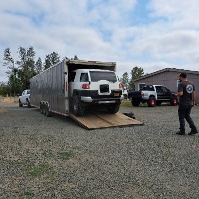

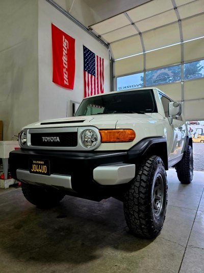

At the shop that I write service for, very part time for this 72 year old retiree, we had a beautiful 2010 Toyota FJ Cruiser delivered to us in an enclosed trailer from southern Ca.
The shop owner friend of mine has a following for his Toyota 4.0 timing cover oil leak repair accomplishments. This rig was perfect and was going to get some engine work that required leaning in to the engine compartment. He has an elevated creeper for most of it. What we also did was lay on the blue tint non adhesive wrap that protected the paint. Peeled it off with no problems or marks.
View attachment 4478View attachment 4479View attachment 4480View attachment 4481
Wow that’s a nice FJ, those have skyrocketed in value

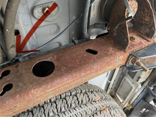

First “cold” night and walk out to the Burb in the morning and see this at the back of the vehicle.. immediately had nightmares of the fuel leak on my Bronco…
Whew. Just a leaky washer fluid line for the rear wiper… patch it or replace the line? Pretty sure there’s a clog in there I tried to use the wiper fluid on the rear window a couple days ago and didn’t work
Try a hose with some small hose clamps first? Easy enough vs replacing the line.
My 06 I think has a clog on the rear line. It keeps blowing out the line at the coupling near the battery. I removed and repainted the wiper arms, and didn't think to unhook the rear wiper hose (or the nozzle?) to see if the line could be flushed out. Maybe try that, in case you got some dirt or debris in that line?
FW_Z71Burb
Oct 14, 2025
222
640
Fort Worth, TX
I just crawled under there and there’s a quick disconnect at the rear bumper frame which is nice. Is there another one on the frame leading up to the reservoir or is it just one straight shot?
Splicing it is probably what I’ll end up doing
