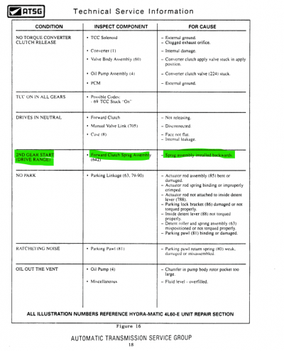

I'm not familiar with the 4L60e, but recommend that you look into the troubleshooting diagnostics on the ATSG manual. Here's a PDF copy of it: https://atoc.ru/uploads/manual/5fb797a513efb.pdf
Is this your symptom?
Doubt a sprag was installed backwards, but it may be failing intermittently.

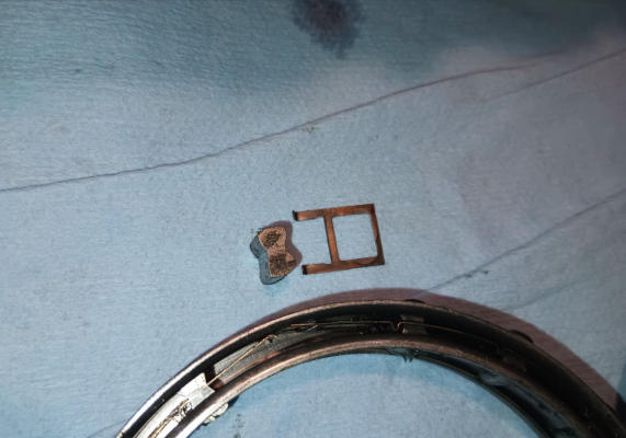

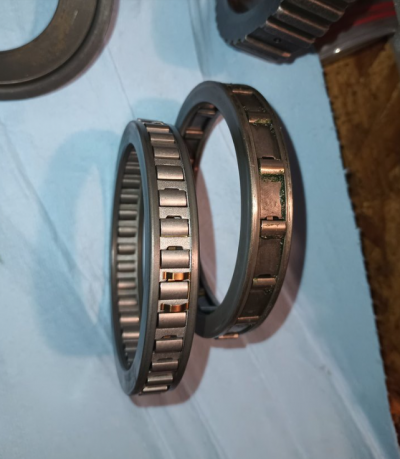

I was rebuilding a 4L80e for my brother's 90 C1500 a few years ago and initially overlooked the direct clutch sprag. It worked well and was at one point playing around with it after my regular cleaning pass, then all of the sudden I was able to freewheel both directions, which is not supposed to happen. I ordered an upgraded, late-production 34 element sprag since that was the early 16 element sprag). When I took apart the old one, the little cage-looking thing that holds the little elements had broken in a few places...

Wow! that's an awesome document - THANK YOU!
I think it's different. Seems that if the clutch were in backwards, it would always act improperly. As it is, it rarely does it, working perfectly the rest of the time. Even when it does do it, I don't remember it ever doing it more than once in a day, or maybe weeks between incidents.

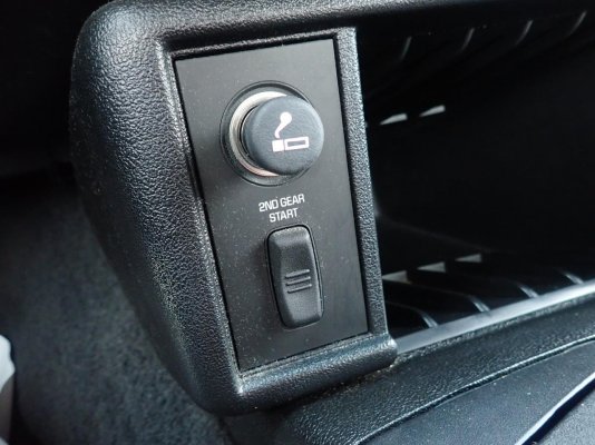

I don’t know what years or applications but some 4l60e I’m pretty sure are normal to start in 2nd gear

It’s not the issue here but I figured to mention it’s a thing that is capable in some applications View attachment 5331
1996 Camaro for example
Interesting... pre-electronic transmissions, especially RWD vehicles, this was something one did to try to keep from spinning the wheels. Several of my vehicles had this ability.
Thanks for sharing!
Thanks for sharing!
The 4l60e is electronic lol. But yes , prevent from breaking traction in normal driving if the tire and ratios and rear weight were conducive to slipping
