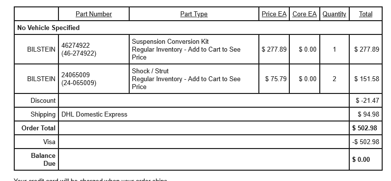

The Yukon is riding splashy (front end does not rebound the same on both sides), so I started looked for new shocks. Was pleased to find that Bilstein has a kit replace the rear air shocks (edit - with new shocks and stiffer coils, non-air) at a great price. Here are the part numbers if anyone is looking.

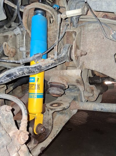

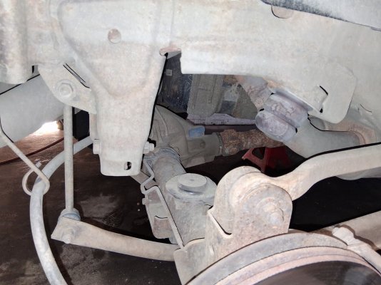

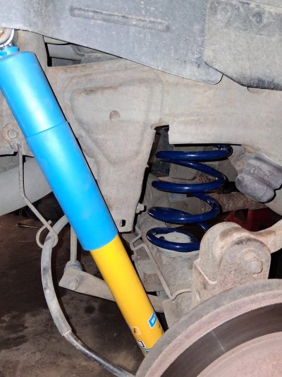

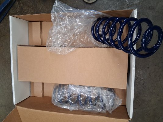

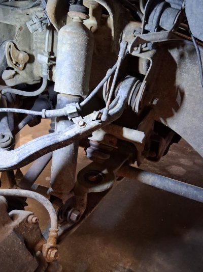

Got this done tonight, very easy with the help of a 14 year old son. Fronts, no brainer, only issue was the shock bolt on the driver side was stuck and had to use kroil and a ball-joint c-clamp to assist it. The backs we simply jacked up and removed the shocks, pull the springs out by hand and install new springs, used floor jack to lift axle while holding spring in place. It appeared better to do driver install first and have the passenger spring set as best as possible. I think the driver side drops a little bit more is why. 20250821_185201.jpg20250821_191658.jpg20250821_201131.jpg20250821_201151.jpg20250821_203332.jpg
