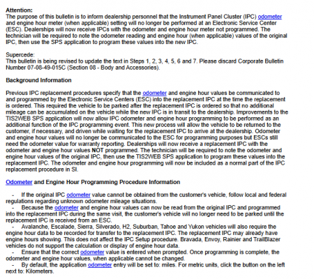

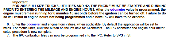

you need a IPC without any miles or hours in it in order to program it. which im not sure how one "resets" the IPC or if its possible , it wouldnt be a factory method. maybe people who hack and know their way around modules and EEPROM and PROM can figure out how
