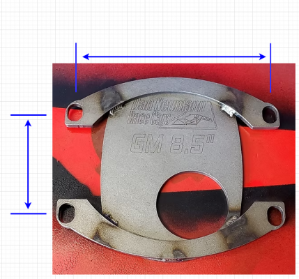

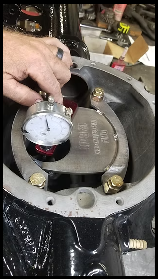

Our friends at dnracecars.biz have agreed to fabricate an ingenious tool to take a lot of the guesswork out of setting pinion depth, but I need the measurements first.

It's based on finding the centerline of the carrier/axle and then measuring the distance to the pinion face. Once that measurement is known, you can determine the correct shim for proper pinion depth.
