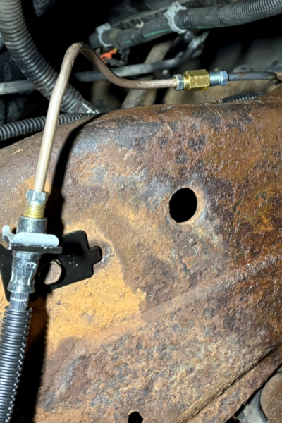

Recommend the OEM brake hoses signifcantly over the aftermarket
this is an OEM hose, but the aftermarket i had was a slightly smaller hose, shorter by an inch or 2 which caused ti to pull tightly in turns (2500HD, maybe wouldnt on a 1500) and the bracket was cheap
