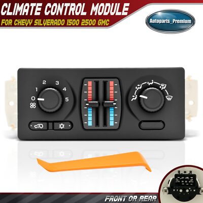

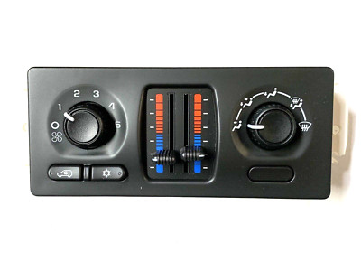

BlackRose#1
Jan 2, 2026
5
Springfield
I've been searching Ebay for years now! I know that sounds like a stretch, but from time to time I will find all the OE part numbers and just throw them in an Ebay search, but I haven't found anything good yet. Just a bunch of new no-name generic garbage. Good suggestion on the blend door actuators, I'll make sure those aren't faulty too. They are all noisy, I can hear them when I move a knob or adjust the slider. I am really thinking the issue lies in the control, but I could be completely wrong. Seems like something is internally shorted specifically on the AC circuit somewhere. I don't have issues adjusting the fan or temperature when it is cold out and I need heat.
So, I guess the search for an OE piece continues. Not really a bad thing, just means the wife won't want to take my rig when the weather gets hot.
I have an issues with the firewall insulation rubber drying out and breaking off and actually crumbling and interfering with the actuator motors, creating a whining and crunching sound resulting in the system going to. Default on constant defrost. Be aware, if you go to O'Reilly's for a MODE actuator, they will sell you a blend door. I learned this
by calling doman directly .if it's a plastic gear, it's not a mode, but a blend door.
