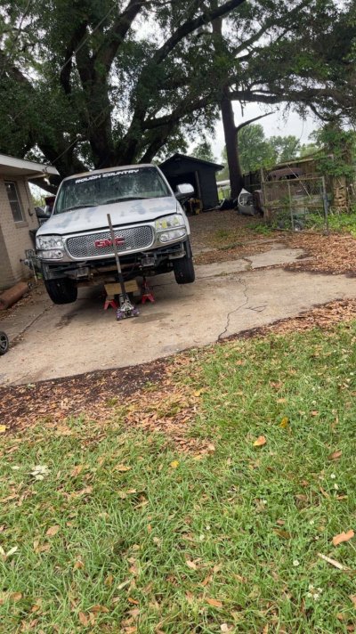

Tl;dr, need harness diagram for harness that goes from steering column to under the hood.
Hey everybody, got a bit of a headache with my monstrosity of a truck. So to keep it simple i took the whole drivetrain and every single last wire from a 2003 silverado and put it into a 2001 silverado. Nothing would swap over thats why i had to swap everything. For a while the truck was blowing an IGN E fuse and refusing to start. From what i know this ign e circuit powers part of the gauge cluster, ac compressor, blinker switch, and the starter fuse. After poking around and frustratingly tugging on harnesses the fuse no longer pops and the truck runs and drives! Unfortunately, no blinkers, right headlight and none of the gauges work. I can only assume the a/c wouldnt work if it was even charged. My question... does anyone have some sort of wiring diagram for the ign e circuit or a diagram for the interior wires that run from under the column to the underhood fusebox? Ive pokes around endlessly with a multimeter and its just making me more confused as EVERYTHING seems to be grounded ‍♂️.
