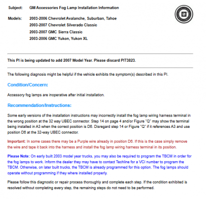

Hi, I recently in november had to fix some mouse damage under my fuse box and thats why Im making this post, i was wondering what the fog lamp switch does if you install it without putting a fuse or relay in, and you simply just swap the cargo lamp switch out for a dual fog/cargo switch. My truck was never installed with fogs, but i have the harness on both sides and fuse box terminals for the relay and fuse.
When i put the switch in, it turns on my parking lamps. Is this to be expected or is that an indication of a problem?
I just pressed it to see what it does, and the park lamps turn on and backlighting on the dash. the backlight on the fog switch also lights up. does the cluster have a fog indicator or just the switch?
