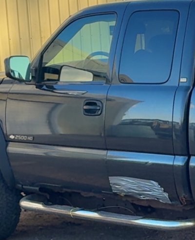

To sound dumb, prior to joining the truck forums a few years ago, I had no clue what "rockers" were. That's kinda embarrassing now that I think about it but I'm being honest. 1765894707593.png

To sound dumb, prior to joining the truck forums a few years ago, I had no clue what "rockers" were. That's kinda embarrassing now that I think about it but I'm being honest. View attachment 4840
Idk what they are either
