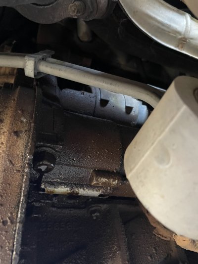

Having the wrong series battery should have been addressed anyway. That is a lot of oil leakage there. How do you know it is from the RMS? that oil could be from back of intake, back of valve covers or oil pressure sender.
Looks like the starter heat shield is there. That is a plus.
mechanic (i trust) confirmed it's rear main seal last time he did the oil change on it after I asked him to look it over and confirm where it's coming from. but i suppose it could be from somewhere else harder to see
oil leak has been about 3/4 of a quart 2000 miles in.

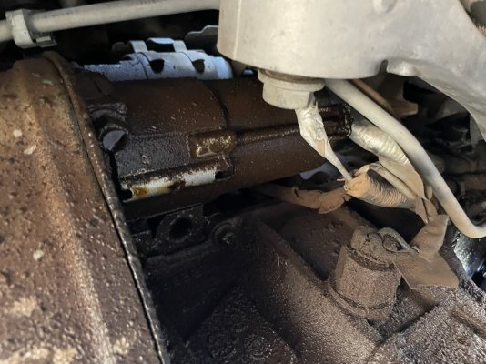

good to hear on the heat shield, I was thinking heat soak on the starter but weird that it would pop up now.. my cats have been rattling lately during warm up imagine they're on their way out but they didn't look hotter than normal or glowing when i crawled up under there, and the truck drives fine no CEL
think engine oil on the starter might be causing it? I could hit it with some engine degreaser and try to clean it all up with a brush
The oil gets in the solenoid and at the starter drive gear. I would be curious how the mechanic confirmed that it is a RMS leak? Did you ask the steps he took to verify that?
makes sense.. solenoid is on top and looks a little cleaner?
didn't ask him how, but i know he didn't clean it all up and put dye in the oil or do anything like that.. used his trained eye i guess
You can remove an inspection cover or a portal cover at the transmission bell housing and look in there for oil flinging out on the flex plate surface or use a borescope in there.

Can’t replicate the issue, cranks and starts completely normal now. Cleaned up the starter anyways. Thanks for all the help we’ll see how the next few days go
