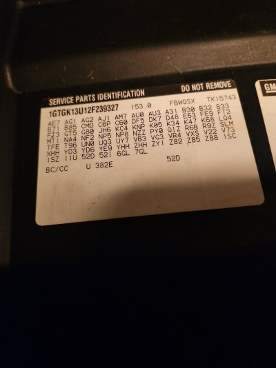

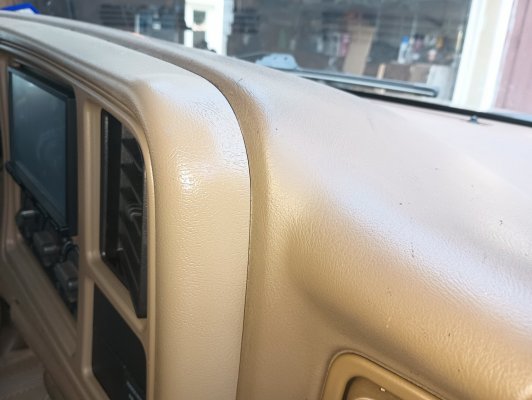

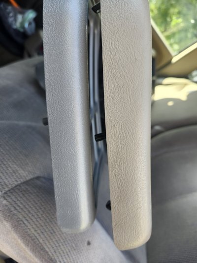

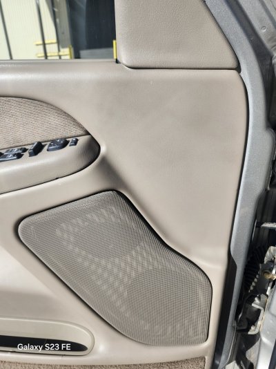

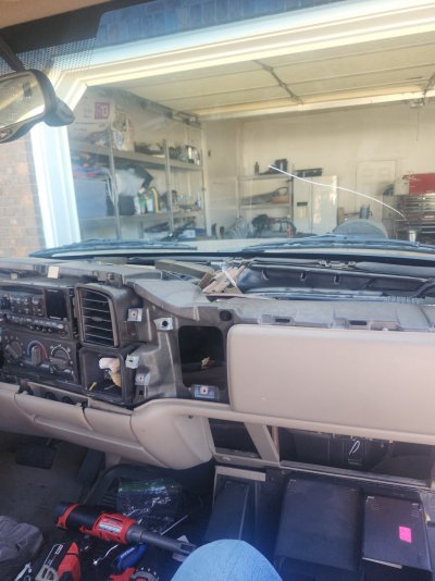

I was looking to install a double din bezel on my 2002 gmc sierra 1500hd. I went with chat gtps recommendation of pewter. It did not come even close to my interior color. Did a little research and im getting medium neutral. I I'm not finding any bezel that look even close to a tan/beige. Anyone else know of a place that sells light tan double din dash bezel? My rpo code is 52d / 52i1000011638.jpg

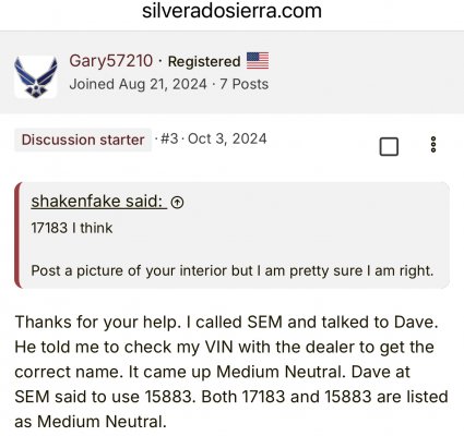

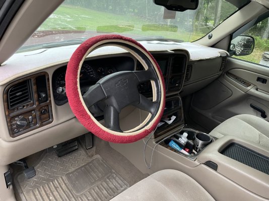

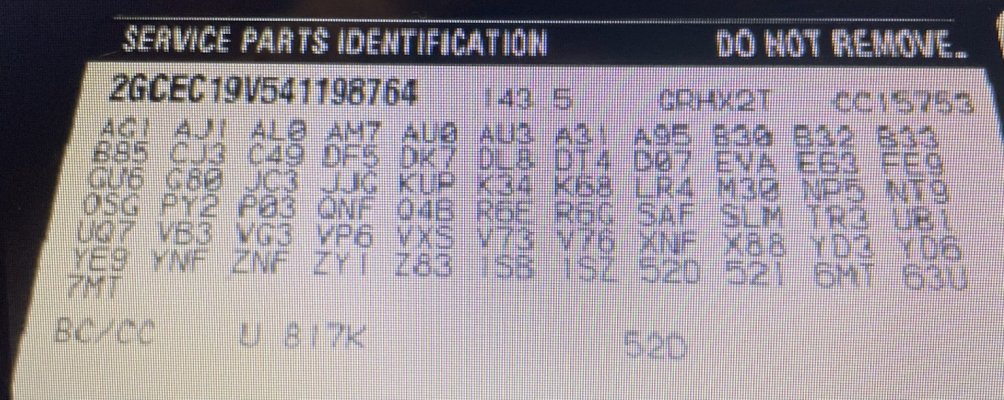

You might have to paint to match unless you are lucky enough to find a newer truck with tan interior. My 04 has the 52D tan interior. I was thinking there was a SEM paint that closely matched; I’ve got a note on it somewhere.IMG_0140.jpegIMG_9969.jpeg

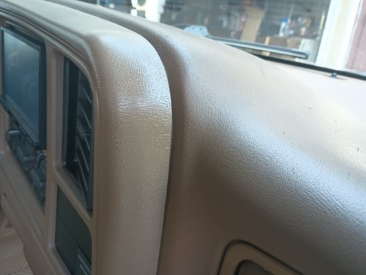

I will take a photo of the installed bezel this weekend. It's a "hair" off on the color match. Something you probably can't tell unless they tell you. I actually deleted my center console for a jumpseat (and along, the kickpanel and glovebox). The new panels are kind scuffed, I plan to use the leftover paint bomb to paint those as well.

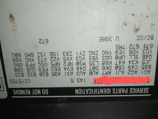

I'll look at the RPO code as well.

Here's what my painted bezel looks like. One photo w/ and one w/o the flash. I'm not sure what my interior color RPO code is, but here's the tag.
BTW, I bought my bezel from Crutchfield and you don't have to do the conversion per that video. It just snaps in.
