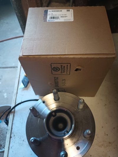

I noticed some pretty bad vibrations when driving on the highway like at 70-75 mph+. Yesterday I checked the tires and there some significant play in the hub. So I ordered some GM Genuine front wheel hubs. I rebuilt the entire front end, and that was the only thing I didn't replace, so I'll do that when I do the big brake upgrade I guess.

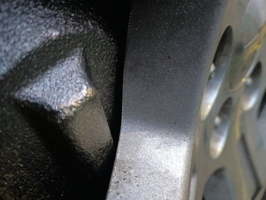

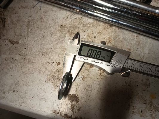

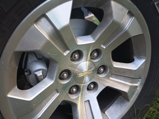

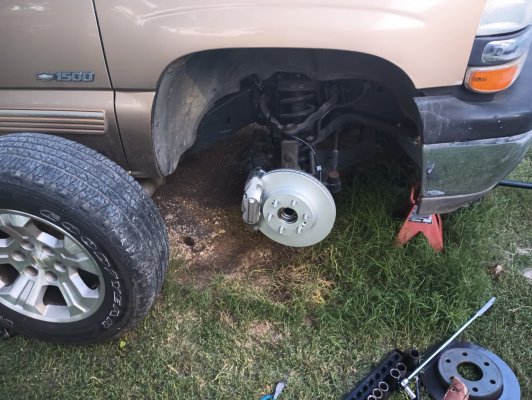

I had a bit of time and replaced the passenger side hub. I did a quick mock-up using the 2019 caliper and rotor, and installed the tire. It looks like it clears, which is not what I was expecting. Ummm
I used 5/8 washers from the hardware store. I was looking down at the caliper to rotor and it looks a tiny bit off-center. I'll install the brake pads over the weekend and see what happens.
I used 5/8 washers from the hardware store. I was looking down at the caliper to rotor and it looks a tiny bit off-center. I'll install the pad over the weekend and see what happens.
I am guessing that you mean you installed 6 of the 5/8" washers between the hub face and the back of the wheel and that gave you the clearance you were not expecting?
