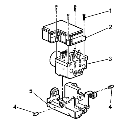

The top part is the EBCM, the thing is called the EBTCM if you have traction control JL4 (i think is the RPO)
The brake lines go into the BPMV or brake pressure modulator valve which is in the middle here above that contains the motor and valves for ABS and rear proproportioning

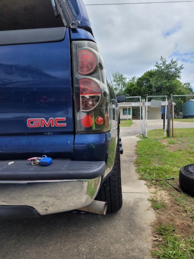

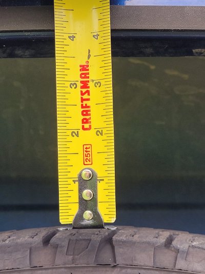

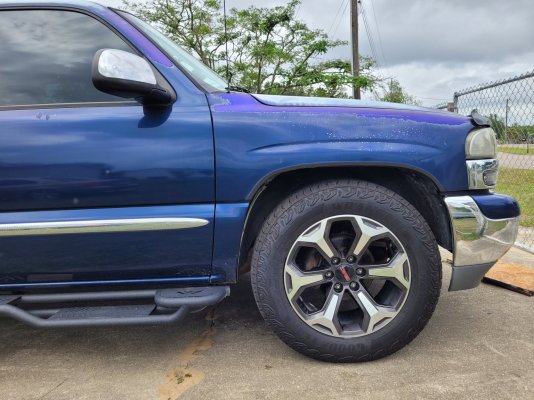

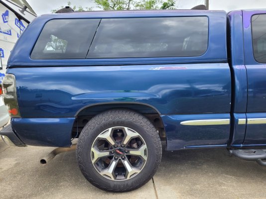

So i measured the front & rear wheelwell openings at the mid-height of the hub, they are 35in across. So fitting a 33in in the opening shouldn't be an issue as previously concerned by someone?
Finally got a rear mounted.
Plenty of clearance all around.
This is with an empty bed.

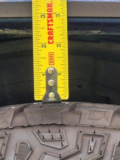

I should be good enough to 2k lbs in the bed w/o touching the tire at stock 26yr old height?20260409_121258.jpg20260409_122100.jpg
Great news!
You can measure the distance between the top of the rubber and the wheel well, then compare that to the distance between the jounce stop and the axle pad. Probably should be fine. I think the payload on these is rated for around 1500-1600lbs?
But I once loaded my truck with a full yard of wet sand, which was like 2600 lbs. Oooops! LOL

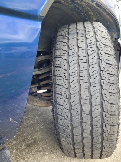

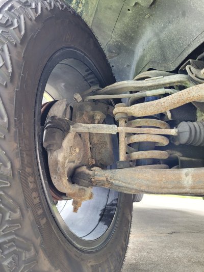

Here's the front. On its own weight. I still gotta turn the wheel to see if it catches anything?
Yeah, I know, wrong lugnuts. I'll get the correct ones once I know for a fact that there isn't any issues with fitment.
Looks like you have a lot of room...Yeah, I have those standard lug nuts on my wheels too. SMH.
Maybe try to find a ramp or steep driveway where you can turn the wheel while flexing the suspension just to make sure you don't rubbing?

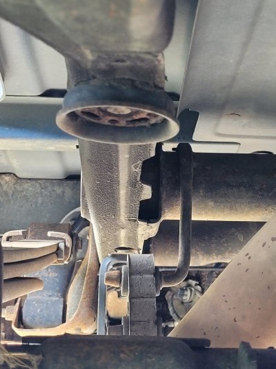

Rear
Front
Funny enough, both of my bump stops seem to have disappeared.

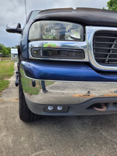

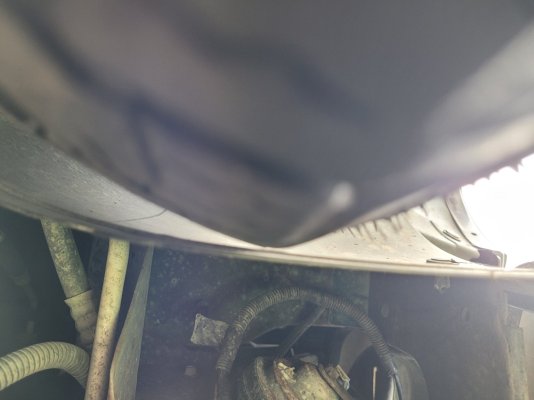

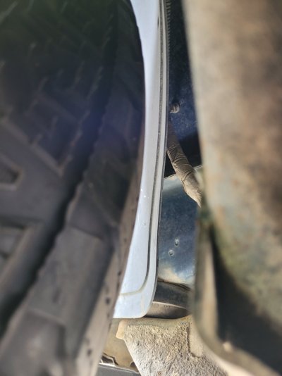

Full lock to the left.
Plenty of room at the rear.
Barely any room at the front.
There is some flexibility in the liner, so maybe making something to force the opening bigger?
I'll drive on my neighboring crappy road 1st, then I'll look for any signs of touching on the liner.
Close enough to kiss! :)
Ya, those rear jounce stops are like bad girlfriends: they hang with you so long, then don't even say goodbye when they disappear...SMH
