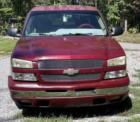

The bumpers probably mount the same but they are different. That being upper cap, lower airdam, and bumper itself. The top cap dips down in the middle to clear the grill and the driving light are different between the trucks. View attachment 5117
Thank you is this yours? What’s modifications did you do the the core support and headlight brackets
Mine is an 04. I figured that pic would be best way to show the difference in the front bumper. I had just painted the upper bumper plastic (not my best job but wanted to see how close I could get to factory paint). After an accident, I used an Amazon replacement black grill painted to match. Awhile back, I’d gone with clear corner chrome lights. I do prefer the 03-05 look over the 06-07.
