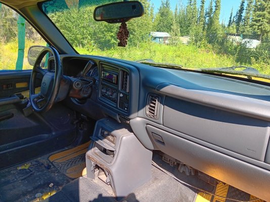

Pics would be great, thanks. I'm heading over to my buddys to see if i can grab some duct work from the console truck
2,646
4,847
So here's a pic of the console and the connecting duct.it connects directly to the bottom of heater box which is definitley different than mine. It's a nightmare to change the heater box and i don't want to hack mine up so unfortunately i won't be hooking up rear ventsView attachment 3241
So, no way to mate the ductwork together under there?

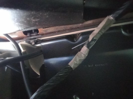

Here are my photos. Suburban does not appear to have a block off plate. The one with the duct tape is my 99 Silverado.
