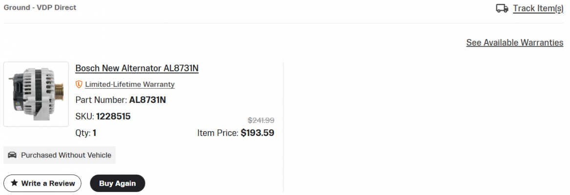

Hi all, Just thought I would share this in case anyone is in need of an alternator. The reman one made it 10 years or so, but it was on its last legs. These trucks mainly came with either an ad230 or ad244 alternator. The early year ad244 was rated at 130 amps while the later trucks got 145 amp ad244. This Bosch is rated at 130 amps and was quite a bit less expensive than the 145 amp Bosch. With the 20% off online order code through The Zone it was cheaper than many options on RA, with free shipping and a lifetime warranty. New, not reman. Now, my 04 has crank windows and manual locks, so I took a chance and figured my WT model didn't need the additional 15 amps. It has been installed for about a month now with no issues to report. Hope I can help someone else save some cash!

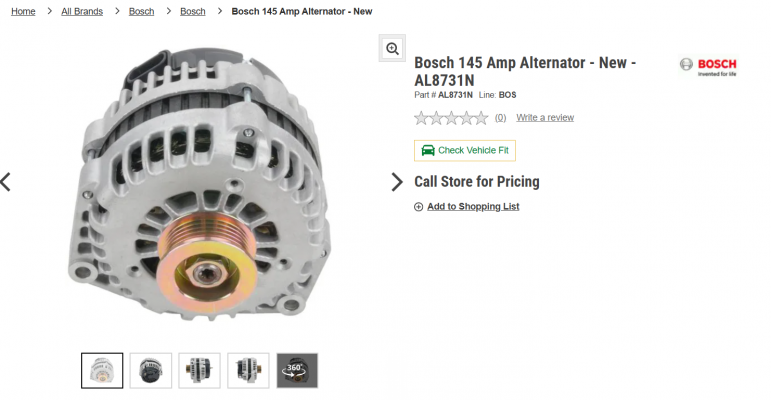

Amazon says its a 145 amp (the bosch you bought) so you likely have a 144milimeter stator AD244 functionally

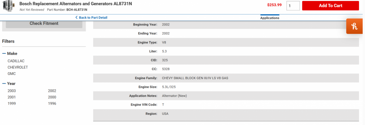

Gosh, I totally forgot about those early GMT800 OE bosch units! You are completely correct, this is not an OE Bosch style unit. The one I installed is Bosch made copy of the OE Delphi AD244. New and manufactured in USA, which was sort of a surprise. I've leaned towards bosch the past few years as others quality has fallen off. They seem to make good quality parts, or at least put quality in the box. I installed a Bosch fuel pump assembly in the 03 Mustang that had a Walbro stamp right on the hanger.
The strange part about this aftermarket Bosch AD244 variant is that it is not listed as compatible with my 04 anywhere. Here is the compatible "Applications" according to Summit.

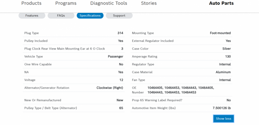

And then here is the product specs from Bosch's website which lists it at 130 amps.
Subject:Incorrect Amp Code On Generator
Models:2003-2004 Cadillac Escalade, Escalade ESV, Escalade EXT
2003-2004 Chevrolet Avalanche, Express, Silverado, Suburban, Tahoe
2003-2004 GMC Denali XL, Savana, Sierra, Yukon, Yukon XL
2003-2004 HUMMER H2
The purpose of this bulletin is to inform the technician of an incorrect Amp code stamped on the generator. The code on the side of the generator reads 130 A and it should read 145 A. The 130 A has been stamped on the generators in error and does not indicate the actual amperage of the generator. A 130 A generator is not produced for this vehicle. The correct replacement for the above vehicles is the generator with the 145 A marking.​
