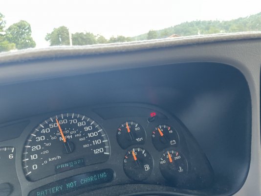

Pulled positive cable off while running and truck died.

This wasn't good for the old 10si and 12si alternators. Plain ol' bad for anything more modern. Generally, if the truck is telling you it's not charging, it is correct. Even mostly dead batteries will allow the alternator to work.

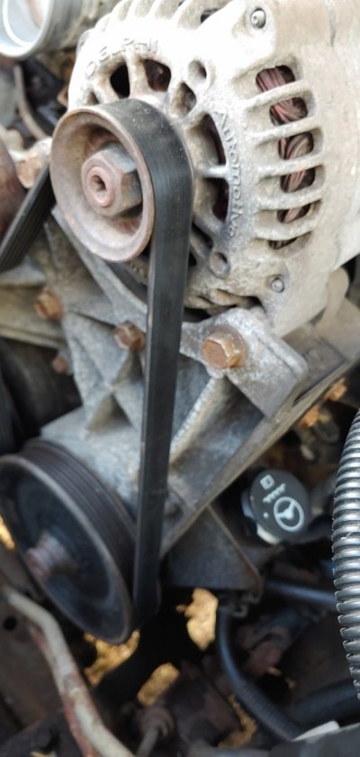

you can tell by size, your alternator looks like this if its stock 105, mine is too (sad!)
But the case of the 140 is physically larger and the front air vents are differently placed, it will have a larger pulley too
The stator diameter can be roughly measured by the case diameter but you need to by able to eye the distance well on a ruler or tape measure

also yeah NEVER Pull the battery cable. your truck saying battery not charging is telling you its not, and a DVOM confirms it. the thing could have a bad excite wire, which can be bypassed with a 194 bulb base and a bulb (cheap at auto part store) you put one end on the batteyr positive an unplugged you would touch the L terminal

I checked DMM and it was barely keeping it at 12.
I stopped and picked up a new alternator and on way home watched the voltmeter slowly drop to 9 volts before the truck shut off and wouldn’t restart. Ended up changing it on the side of the road and after jump starting it, it’s been running fine and charging at 14 volts.
