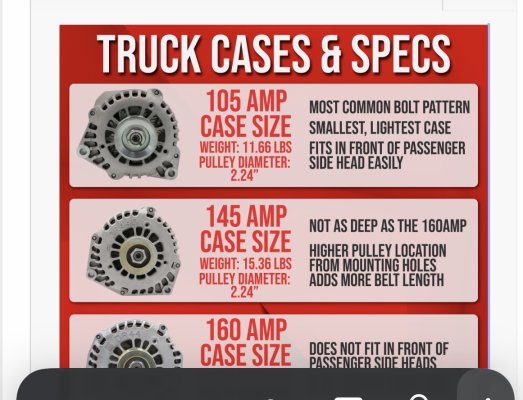

One issue I ran into was that I could not get the upper belt installed. It was too tight. I slacked the tensioner pulley all the way and still could not get it to go. I ended up having to use the old belt, and luckily it still looked pretty new. I read that there are at least two different sized of alternators, so maybe I have the larger one? I looked at the alternator before I bought the kit, and thought I identified it properly. I'll take another look, unfortunately, I don't remember if I thought it was the larger one or smaller one.
Question: is the new belt that goes around the crank shaft and alternator super hard to install when new? I think if I somehow would have gotten the new belt on it would have been way too tight, but idk.

Comparing the new belt vs the old might tell you if something is off. Otherwise checking to see if everything is set up correctly.
I noticed the old one was a little bit bigger. I wasn't sure how much a belt would stretch, but it actually did still look pretty new, so I'm guessing it wouldn't have stretched all that much.

You either got a different size pulley or wrong belt. Put the old tensioner to figure it out...

Look up the RPO codes in the glove box and it will tell you what size alternator you have. They require different belt lengths depending which you have.
FYI, take a picture if the RPO codes and give it to AI to decipher. Much faster this way
444
872
105 amp:
Dayco
5060923
Poly Rib Belt
Specifications
Description:
Poly Rib Belt​
Compound:
EPDM, Aramid Reinforced​
Backside Material:
Rubber​
Rib Depth:
Standard​
Top Width:
.82​
Metric Part:
6PK2345​
Number of Ribs:
6​
Rib Profile:
Straight Rib​
Thickness:
.169​
Effective Length (in):
92.32​
145 amp:
Dayco
5060930
Poly Rib Belt
Specifications
Description:
Poly Rib Belt​
Compound:
Backside Material:
Rubber​
Rib Depth:
Standard​
Top Width:
.82​
Metric Part:
6PK2360​
Number of Ribs:
6​
Rib Profile:
Straight Rib​
Thickness:
.169​
93​
444
872
the first 2 are relevant, ignore the 160 amp one

Thanks everyone. You have been a lot of help! I took a picture of my RPO codes and fed them to chatgpt:
Based on your RPO list, the key code here is:
  • KW1 – High-capacity generator (alternator)
For a 2006 Suburban 1500 with the L59 5.3L, KW1 typically corresponds to:
145-amp alternator (standard "high output" unit for SUVs with rear A/C, Bose, etc.)
I just confirmed my Rockauto order, and see that I actually orderd the 105 Amp belt. :confused:
At least I won't every forget what size alternator and belt I have.

Bummer you ordered the wrong one. But at least you know now, and rockauto may refund you if you are still within the window.
