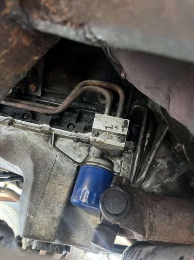

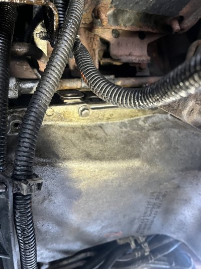

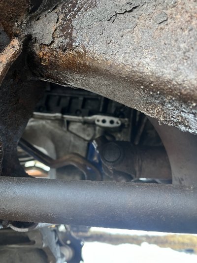

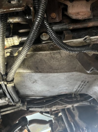

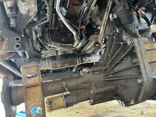

Well, I have the pics of it now that my oil pump went, and it’s been like 7degrees F for a week, got a warm day 20F. If your in there, I dropped the front pumpkin, (disconnect the side axles and driveshaft) and leave it hanging on the rear bolt. This gives you rear and side bolt access for the cooler.

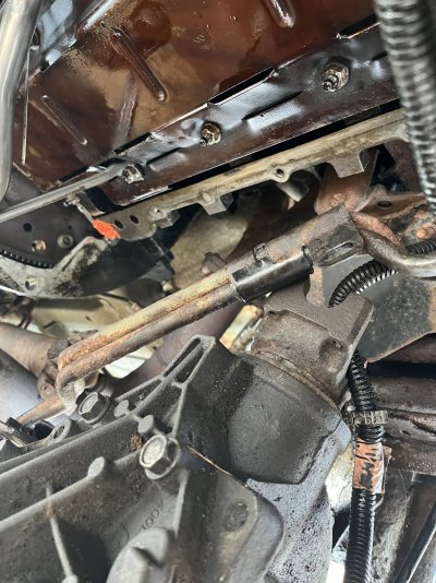

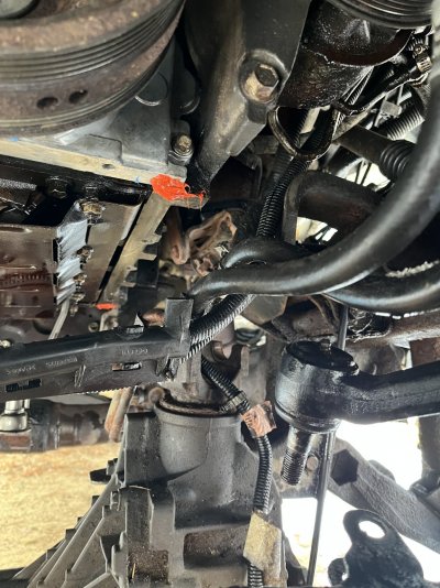

First time around, I had to get into that forward bolt in between the power steering pump and the pumpkin, what a pita. Once I bit the bullet, and committed to the project, the biggest pain is pulling the front crosslink and those cotterpins. Leaving the rear bolt in, but untorqued, you drop the axle down and clears everything off. This outside on the ground…
