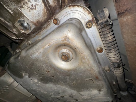

Tried to put the clamp kit on tonight. Verrrrryyy tough. Didn’t have a short 15mm wrench to get off the first bolt. I can see how taking the front driveshaft would help but still a helluva reach and your exhaust flange and pipe are still blocking
Wasn’t a total bust tho. Saw a little shiny red on the bottom of the trans pan and took the opportunity to snug up a few bolts to spec. No drips on the ground just a little moisture
