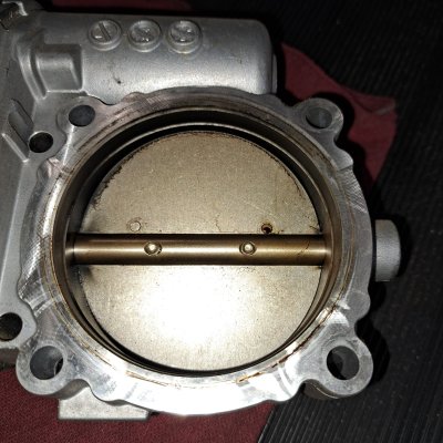

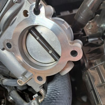

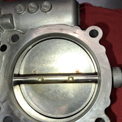

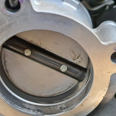

i cleaned it this morning on the truck. i just turn the key on and prop the gas peddle to the floor
and scrubbed the fire out of it with a toothbrush and rags.... it was pretty nasty... it seem to idle a little better.. i have not drove it yet...
You got it clean but it is not clean/clean unless it is removed.
20260504_155612-jpg.6238

yeah yeah i know but me worry bout mo problems if i take off and unhook the wires ..
i did put my new fancy obd2 reader on it yesterday and checked live data but i didn't
know what i was looking for ,, 24 different things to read..... gotta do some studying.
P S mine was much dirtier then that one
