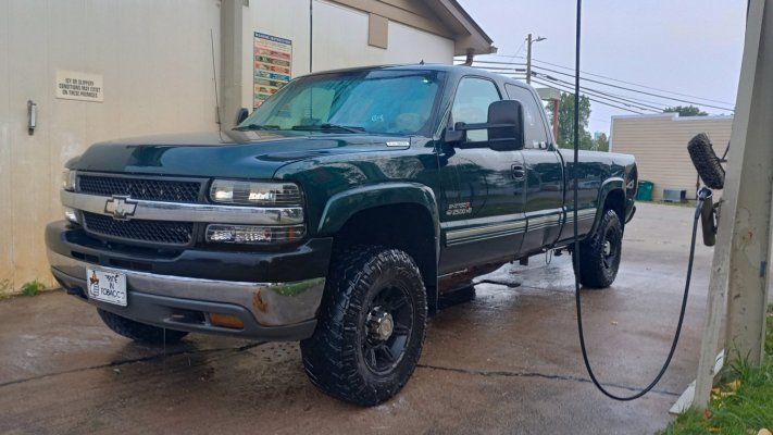

Hello, I have a 2001 2500HD 6.0. Recently, the battery light has stayed on while the engine is running, the odometer and gear indicator stopped turning on, fuel gauge, coolant temp and trans temp gauges stopped working, heat and AC stopped working. Everything else still works. Truck still fires up every time without hesitation. Tested the battery, starter and alternator, all tested good.
