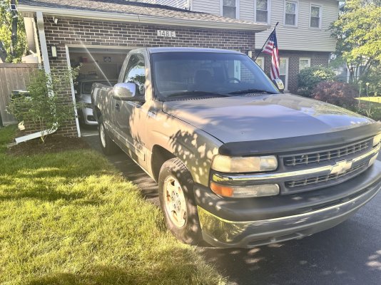

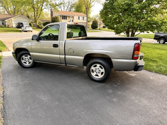

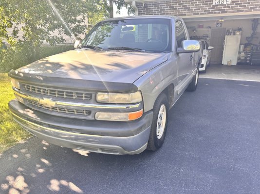

Vehicle: 1-owner truck spent its whole life in Alabama. 2wd, 5.3 truck with basically no rust (what I’d consider no rust living in the rust belt.) Truck is pretty straight, with some bumps and scrapes, but good base overall.
First year of ownership was just getting it in a good driving condition. Shocks all around, rotors and pads all around with rear calipers. UCA’s and ball joints. Started working on things this spring and did an EGR delete, replaced front bottom seat foam and entire metal frame base, and an Airaid tube to the stock airbox. Over the winter, new (to me) steering wheel, 3.5mm stereo adapter using AUX/CD harness, rebuilt cluster.

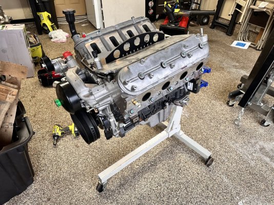

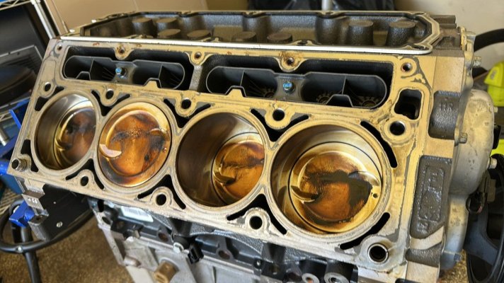

I also have a Gen IV L96 (6.0 LY6 with flex fuel injectors), sitting on an engine stand in my garage. Extremely low hour engine, that had some junk go through the oil pump. Needs an oil pump and bearings, and I would at minimum throw a cam and springs at it (which is not good news for the 4L60…) or potentially go full 408 build with forged internals.
