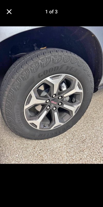

As per Auroragirl's post from GM: https://www.gmt800.com/threads/gmt-t1xx-brake-upgrade.9501/post-28623
, it states that GM says that the biggest 20in tire that we can fit on our trucks is the 275/55R20. I currently have the 2025 factory 275/60R20 tires. So my tires are slightly bigger than what GM recommends. Maybe I'm barely good or maybe not? Time will tell. I'll be going on a longer drive potentially this Thursday. I'll report back on my findings.
445
873
the minor height difference is going to probably be why you had rubbing concerns , so if it ends up not being too bad, one could minor minor lift the body or drop the tire size when its time to put new tires on. good to know it was close in size
