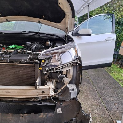

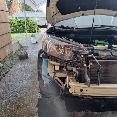

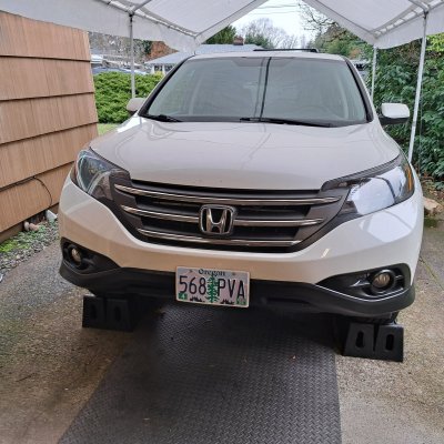

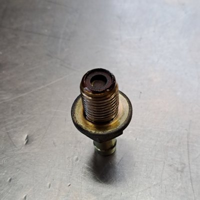

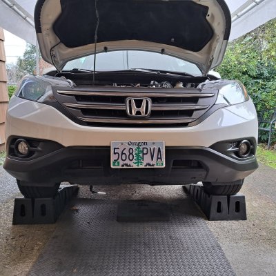

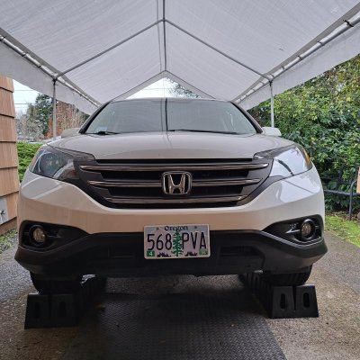

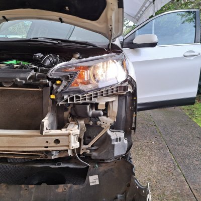

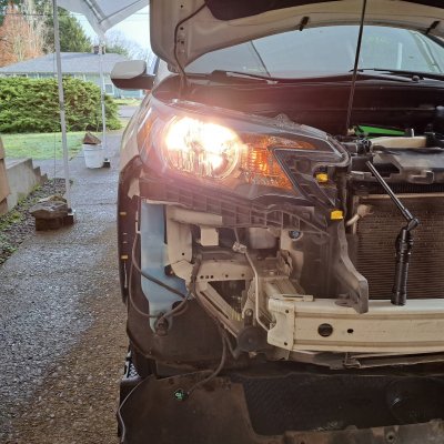

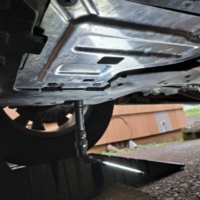

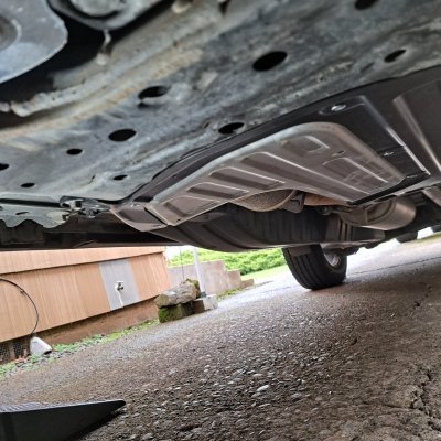

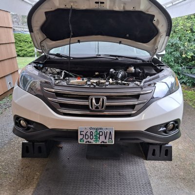

Ok, finished up this morning. Installed the headlight assemblies and checks to make sure all works and installed the front bumper and grille assemblies and then the pcv valve and then the 2 lower shields.
If you look close, at the 1st 2 pics, you will see the blue painter's tape on the bolt heads, where I made them tighter to allow to get way back in the respective holes, without having the bolts drop.

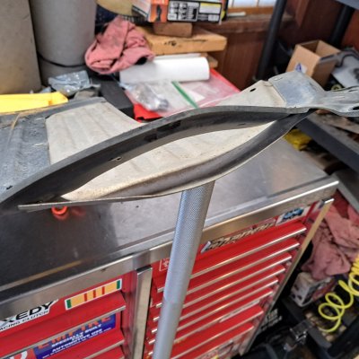

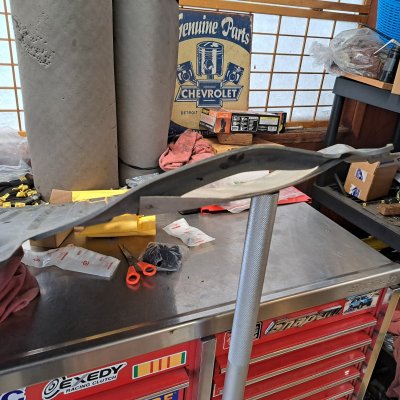

^These are great for wonky skid plates.

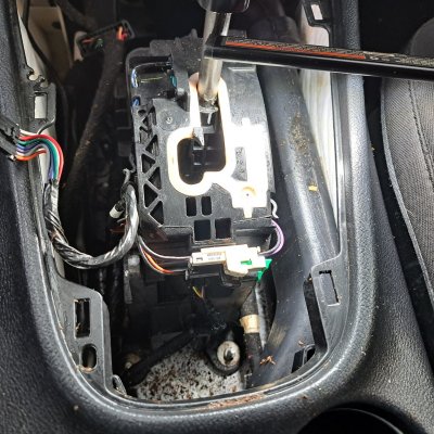

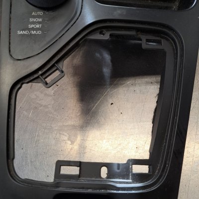

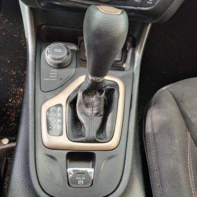

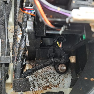

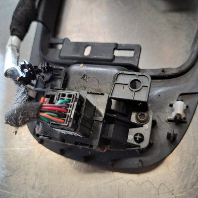

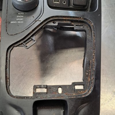

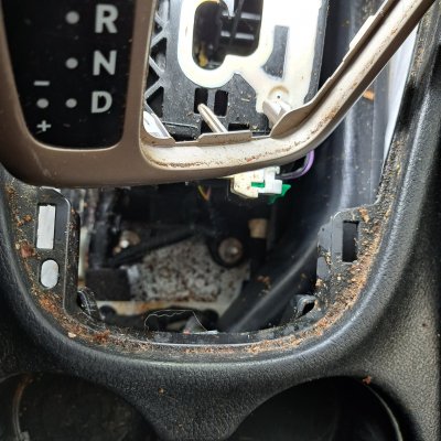

The daughter of the Corolla owner has an ongoing work after work piece of crap 2017 Cherokee Latitude 3.2 engine. I ordered in Mopar park brake switch and the transfer case switch, known as a Terrain switch. Plus front pads and rotors. very thin pads.
Opened up the console and there was filth, I mean FILTY. Spilled fluids and dirt. Had shorted out the 2 switches. She may still need a PTU assembly, better known as a transfer case. Well known weak spot for these rigs. Trying the shorted out switch first. I am doing the switch and if needs transfer case, a well known shop in town will do it. Cleaned the console area and installed switches and they both work and no "Service 4wd" light so far. Then on to the brakes. A whole other story there.

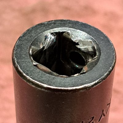

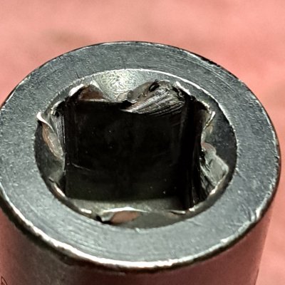

The lug bolts were the one piece lug nut/stud design. They have the caps on them too. Someone had over tightened them and I could not get some broke loose with my highest torque rating on my Milwaukee Tool 1/2" impact. She is gonna get some Dorman 611005 solid one piece with no caps on them and take it to a tire shop for removal before I do the work. It was a Husky deep 1/2" drive impact socket that is 19mm. I just ordered a new one from my Snap On guy.
I found out that the lug studs and/or lug nuts, with the tin caps, get rust build up under them and swell the tin cap. I arranged for a trusted shop that I send work to that I do not want to do, has dealt with this and I found out there is special impact sockets that are .5mm sizes. Example, the tech has 19.5mm impact socket to deal with this. They are gonna use her supplied parts, that I found, and is gonna swap out all the capped lug studs, replace the front Mopar pads/hardware and Mopar rotors and allow my military discount and do it all for $165. I searched and found that Snap On, Mac Tool and Matco and SK do not make these .5mm sockets. I did find a set from CTA Tools and no more than I would use them and for $67, I bought them at Amazon. It will be a "just in case" thing.

Some loose 3/4" sockets can be around 19.5mm too. I've done that on some that are slightly swollen.
