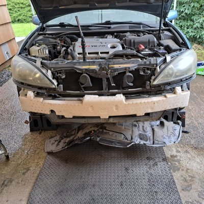

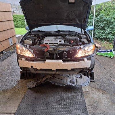

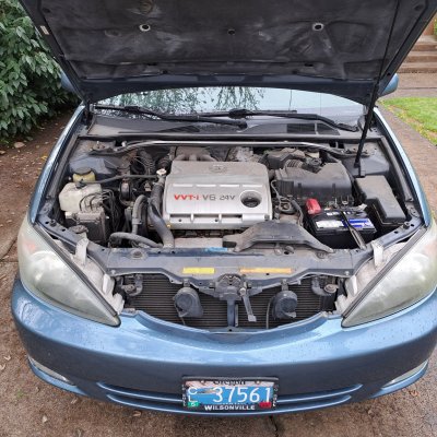

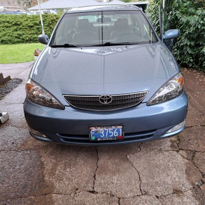

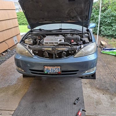

Bought a 2003 Toyota Camry SE for $1000 from the mom of the taco place/bar manager that me and my AL friends eat tacos at every Tuesday and Thursday. Going to clean it up and sell it.

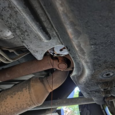

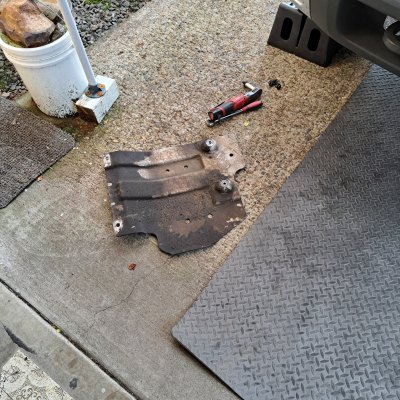

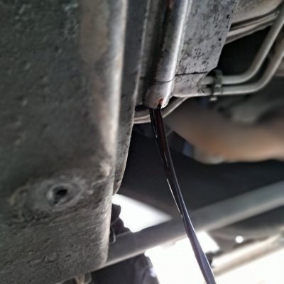

Fixed a squeak coming from the steering column. Rubber boot rubbing steering shaft at the bottom of column at the firewall. Needed new headlight assemblies because the old ones were really bad.

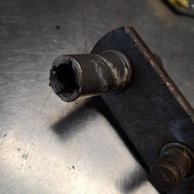

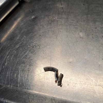

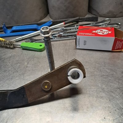

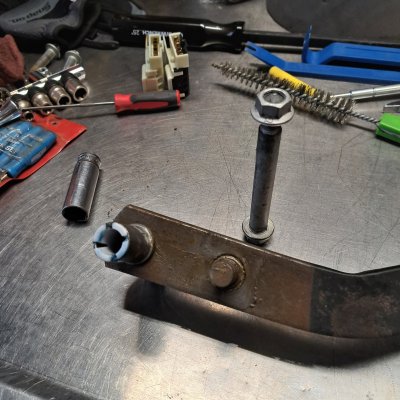

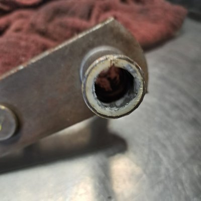

Ok, so today my AL friend dropped off her 2005 Tahoe LS for the brake pedal upper bushing. There was a severe rattle from the pedal, under dash area, when went over bumps.
No pics from underneath because was just too crowded and there is a few videos at you tube to look at. Here is a link to a good one:
I took the driver's seat out and laid under there and reached up but was still very cramped. Hard to take apart the pivot bolt but all nut and bolts removed, including at seat, were thread chased and was way smoother going back together. The pivot bolt is 18mm at each end. The seat nuts at front take an E18 and the back bolts take an E14.
I also installed a new brake light switch. Everything went to plan and was a 3 hour job.

my 02 was blue, had the squeaky steering , and 3.0V6 too.
with the V6 they had lots of juice.
think 03 was the 1st yr they made Camry's in trumpy's - merica.
looks in good shape, should be able to sell that easy for the right $$.
how many miles?
191021 miles. Averaging slightly less than 8700 miles a year.

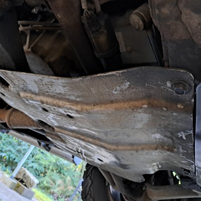

Did an oil change and inspection today on my dentist's assistant's 2009 Silverado K2500HD 6.0. 154435 miles. Had to remove the aluminum skid plate to keep from oil running all over. 4 bolts, 15mm head, and easy drop and reinstall. They had been told by another local shop that the transmission fluid was dark and needed changed. The fluid is bright red and clean and full. The transmission cooling lines are leaking but the other shop said nothing. The oil cooler lines are dry. Did not see any other leaks. The other shop said the shocks needed replaced because were leaking. They are bone dry and work just fine. There were numerous other "concerns" and the only thing I agreed with was when I looked under the hood 2 months ago, before she finally got it to me, that the battery was nasty and corroded badly and old and needed replaced. They had a battery store in town put a new one in. The shop said ball joints were bad, there was not any play.
