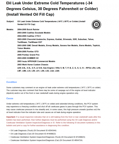

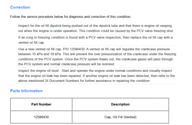

there also a TSB for oil burning in cold climates that see freezing temperatures, that amount of oil burning is excessive, and it replaces the oil cap on the passenger valve cover. The cap incorporates a relief so if the PCV line is frozen it vents excessive pressure
The new valve cover, and this , would be wise in a cold place. But the valve cover is the biggest part. If its burning oil such that its constantly sucking liquid Oil, that will definitely cause driveability issues. but the catch can should be minimizing that

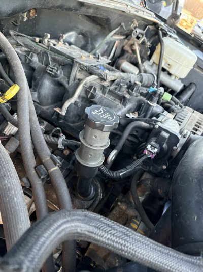

Did not know about the oil fill cap but each time I have done the valve cover updates, I insisted on new cap and tube.
Did not know about the oil fill capp but each time I have done the valve cover updates, I insisted on new cap and tube.
Tube? like the one between the valve cover and cap? I want to eliminate mine, but valve cover doesnt leak so i dont want to do it tell it needs it lol
Despite this calling for -30 degrees and colder weather, I have a feelinng the same thing happens at much warmer temps because the air from the PCV valve is going to be under vacuum, lowering the freezing that its already under for water by far, AND that its vapor which has a high surface area that can lose heat quickly, going through a small orifice (2003 or 4+)
View attachment 2529View attachment 2530

I like the tube sticking up there. Makes it easier to refill after oil change. I know the tube can shift a little when trying to remove cap. I just use both hands and grab the tube to keep from shifting.

I just like the look without it
but im a hypocrite, if you open my hood youll see this
I wanted to see if the 3800 extensions (for the engine cover) worked on this.. they do lol. The cap unscrews the top 2 with it because its tighter up there than those are haha.
Good thing you explained the pic. I was getting ready to call you out.....:eek:
