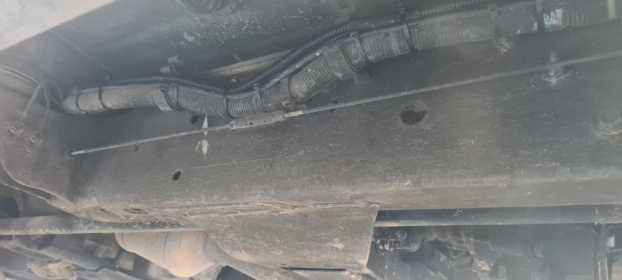

I've looked and removed undercoating... nothing from the front to the end of the passenger door. Inspector wont let me pass without it. Until found or re-stamped (which requires a permit from "DOT") it is basically considered illegal.

To my knowledge, these trucks do NOT have the VIN stamped on the frame (althoughthey do have a code which I believe pertains to cab/bed type?), but I may be wrong. I can look at my GMT800s later and hopefully someone else can chime in on the question...

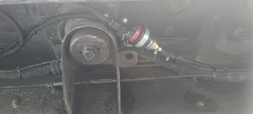

The dutch really should not own tools, i had to fix alot of wiring since they badly installed cheap amazon head- and taillights. Same applies to the aftermarket android radio, the wiring was hurt, data-BUS wires untwisted causing my left speaker to buzz. The list could go on...
I stated it was stock, but i did improve minor technical aspects though.

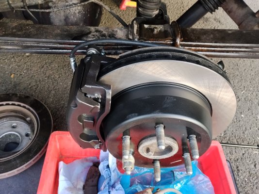

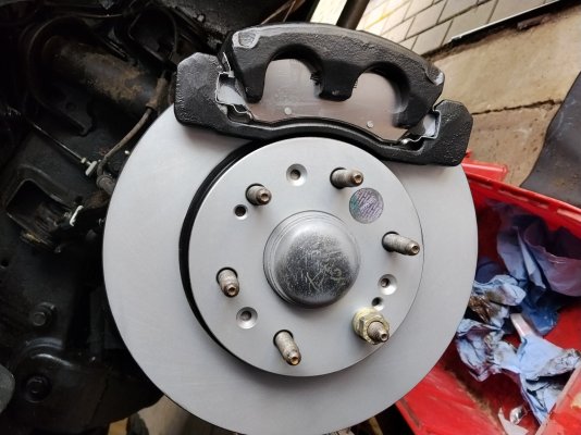

- slightly larger front disc brakes, swapped to the 2WD versions which fit plug and play with new calipers (i am not pleased with the quality of AC-Delco calipers)

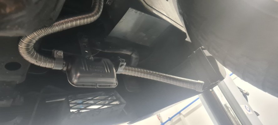

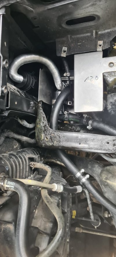

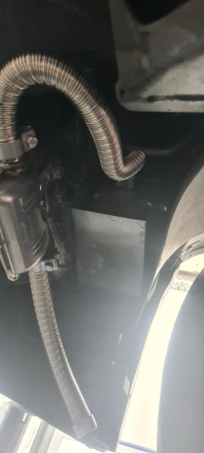

- added a Webasto 5.2kW water heater to eliminate cold starts. Problem is, it preheats to 140°F which causes DTC P0116. I reduced the preheating time to 20mins and then start it again manually once the engine is running. This decreases the temperature difference between coolant and airtemp sensor so it does not set the code.

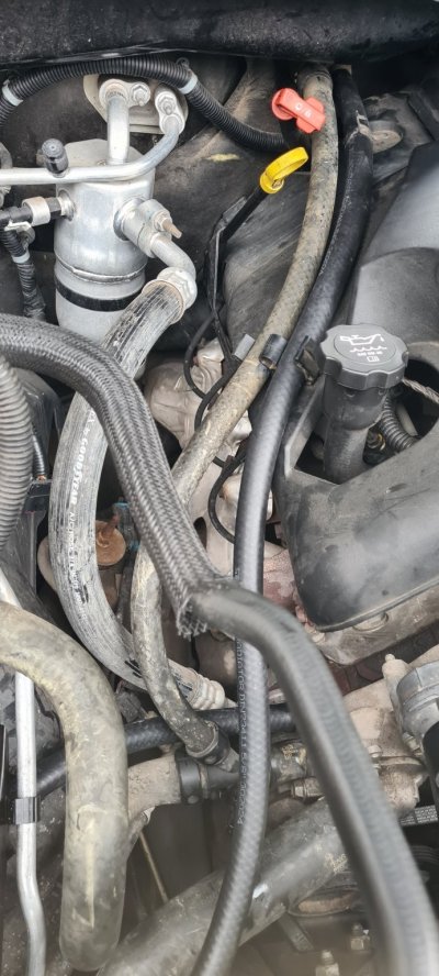

-new engine oil cooler lines

I didn't know there was a difference between the 2wd and 4x4 brakes on these trucks. I assumed they were the same?

Yes, the 2WD version which got sold later since the AWD SS didnt sell good had drum brakes in the rear and slightly larger front discs (I believe 1" more in diameter)

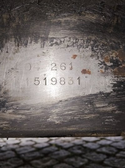

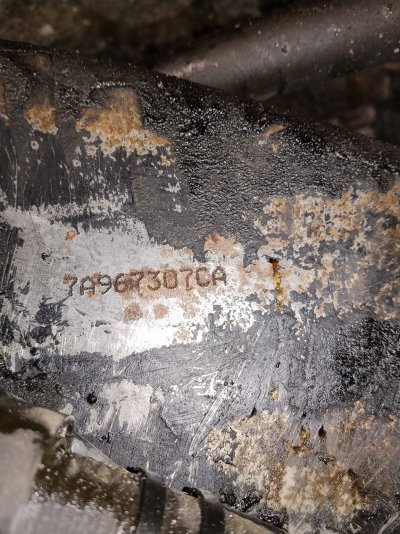

I checked the driver side framerails again and removed some undercoating in the wheelwell... i found this engraved number which is upside down behind the front left wheel.
It is still not my VIN

Das ist die Teilenummer deines Rahmens. Falls du mal Einschweißteile brauchst
