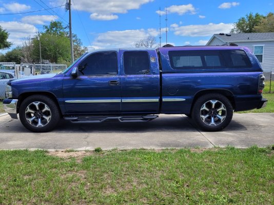

My truck, 2000 GMC Sierra SLT 1500 2wd ext cab.
The 20in rims are from a 2025 GMC Yukon at4 Ultimate. RPO code R4L.

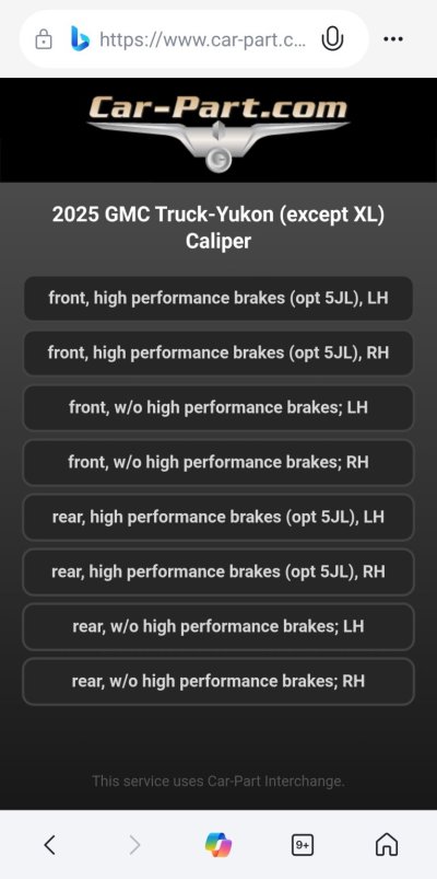

I can find random pictures online of a 2025 Yukon at4 Ultimate with Brembo 6-piston calipers with the R4L rims. But I can't find any for sale for which I could borrow the Vin #.
I took the Vin of 2025 Yukon at4 Ultimate which has a 6.2L & went to the GM website. It says that the 6-piston is not compatible. I don't understand the reasoning?

My original post states I've seen pictures of a 2025 Yukon At4 Ultimate with the same Rim as what I have but with the 6-piston installed. As of this past Thursday night, I could not find any for sale with that setup.
GM offers the Brembo 6piston as a upgrade for the 2025 Yukon at4 Ultimate.
When I put in the Vin # of a 2025 Yukon at4 Ultimate with 6.2L with the same rims as me, it says that it doesn't fit.
What I'm trying to find out is what on a 2025 Yukon at4 Ultimate with my rims, is needed for the 6-piston to be a GM approved upgrade?
