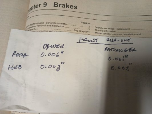

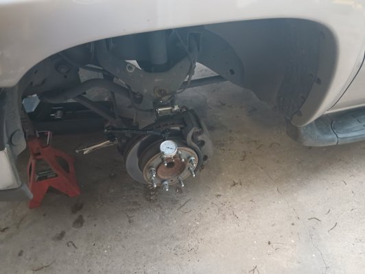

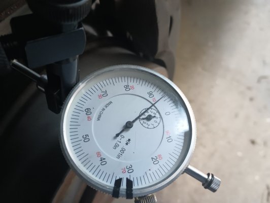

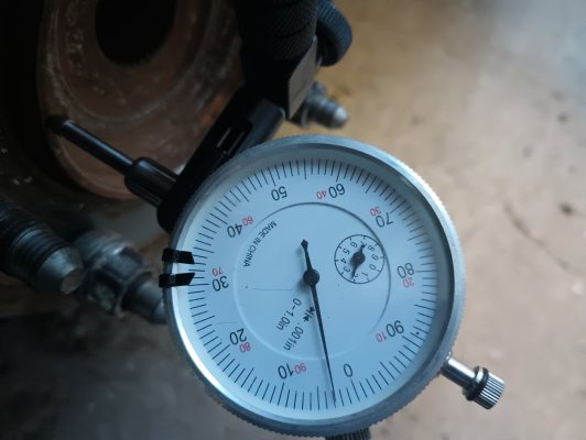

IMO, if the pulsation is caused by a warped rotor that is far enough out of spec, do not machine, replace it and check the new rotor for runout. If the old rotor is machined, it is now thinner and more prone to warping easier again.

So I ordered a set of hub/bearings from Rockauto. I went with the Timken brand. Unfortunately, I'm out of town all week for work, so hopefully I will install them in week 2. Will update that on my other thread for this vehicle...
