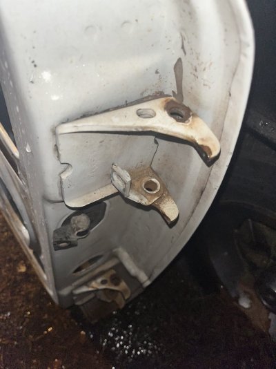

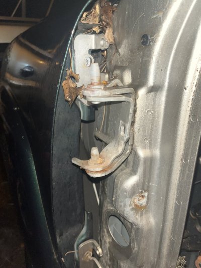

Most of the years, factory are press in pins. Doors with external latches (like the fronts) are 3 10mm bolts, disconnect the harnesses inside in the sides of the dash with a plastic grommet feed thru the cowl, that’s it the doors off. With the door out of the way, I really tried all the non evasive ways of pressing them out, and gave up. Grind the shoulder off and pinch the pins out. Bushing installation, is similar to the gmt400, or the 80’s trucks, some kits have clips after the fact. On the extended cab doors there is a 10mm bolt on the check stop, and a single clip on one of the pins trapping the doors, pop them off and lift the door off.

Yea, looks pretty straight forward really. Fishing the wires from the umbilical cord, after disconnecting from the side of dash, looks pretty easy. 3 of the 10mm bolts and then lift door off. Gotta be strong enough to handle door weight or use a cherry picker and a strap to lift off and suspend while waiting to reinstall. Once the door is off, the grinding has plenty of room and I already have the tool coming to press the pins out after the grinding. I am big/strong enough to lift the door off but finessing the door back on may be tricky. I got a couple retired neighbors that can help though. Hope to be doing this work, next week sometime and I will post pics.
